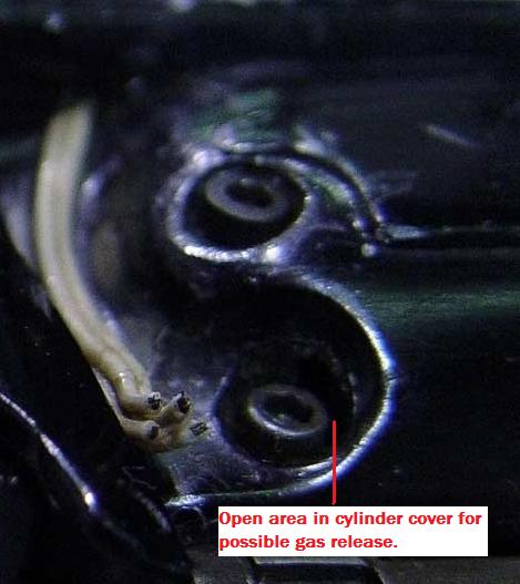

Doc,

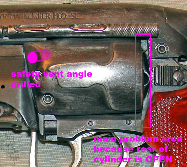

Here is a close up of the Worldcon hero I thought you might like. It is the left Cylinder cover showing a hole hidden behind a screw close to where you put your hole as a gas release.

There is also a gap on the top of that side plate. It doesn't actually touch the steyr reciever. _________________ I don't have enough blasters! |

In the picture below, you can see the problems relating to a Bulldog with its cylinder shrouded, and also the fix I did on my gun to lose the cylinder/barrel gap released gasses. (The right side was no problem because I vented it around the bolt lever, the outfacing screw, and along the top.) The left side is another story. After a test fire, I drilled a vent hole to align with the barrel/cylinder gap. Maybe the cut around the screw in the original prop did the same function. But if you don't get rid of that gas burst, it's going to come out via the course of least resistance. And the back of the cylinder shroud has a large semi-circular gap. Any bit of crap that ended up between the cylinder and the shroud is quite likely to be blown backwards into the face of the shooter, plus the gasses...
