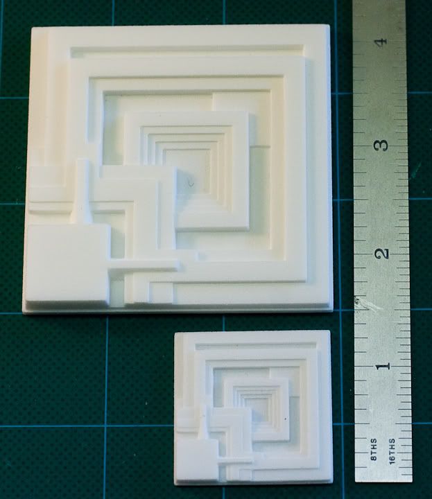

Here are some 3D printed versions of the Ennis Tile at 1/6 and 1/12 scale.

Posted: Sun Apr 29, 2012 2:52 pm Post subject: |
Those are indeed beautiful Dave (and welcome back btw)
The machine uses a kind of plastic to print the tile or something entirely different? |

Posted: Sun Apr 29, 2012 3:51 pm Post subject: |
joberg wrote: | Those are indeed beautiful Dave (and welcome back btw)
The machine was an EOS 3D Printer. It uses a laser to sinter, or melt, a nylon powder, layer by layer, into a solid form. Shapeways has one of these machines. They call it "White, Strong and Flexible". Because this is a powder based technology, the finished surface has a very fine 'tooth' or roughness, almost like that of a sugar cube. For things that need to be very smooth, like the parts of a blaster, this is not so good. But to represent a concrete tile, it's perfect! _________________ Dave

Posted: Mon Apr 30, 2012 2:56 am Post subject: |
Those look outstanding Dave! I am a little curious about the scale though. They look a little large since I was under the impression they original tiles were 16" wide.

Posted: Mon Apr 30, 2012 9:04 am Post subject: |
andy wrote: | Those look outstanding Dave! I am a little curious about the scale though. They look a little large since I was under the impression they original tiles were 16" wide.
Nope, they're exactly the right size. 1/6 of 16 inches is 2.666 inches and 1/12 of 16 inches is 1.333. _________________ Dave

Posted: Mon Apr 30, 2012 11:04 am Post subject: |
the tiles look wonderful... and exactly the right size. the back lit photo made me think of new images to make now _________________ I've had people walk out on me before, but never when i was being so charming |
