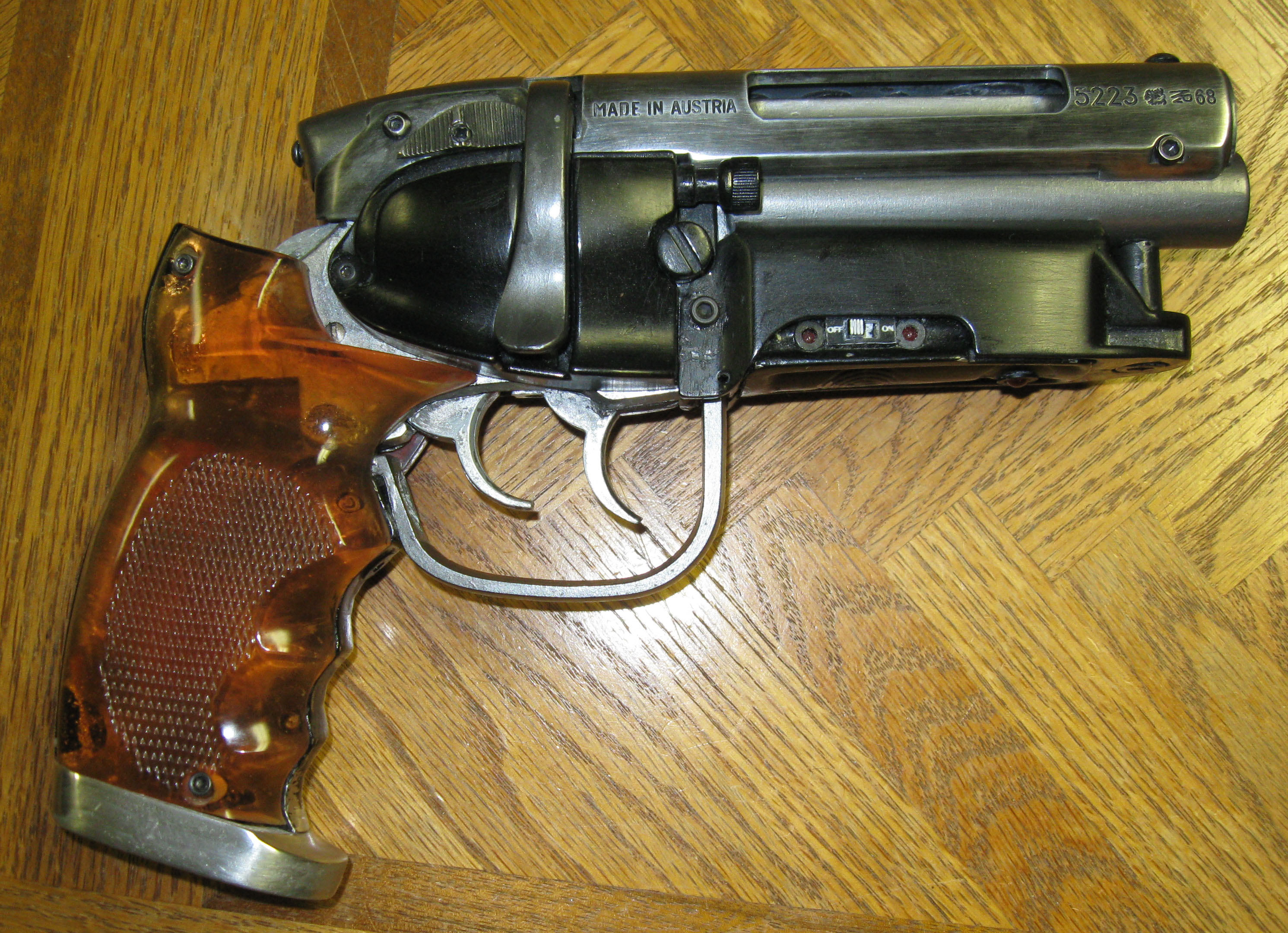

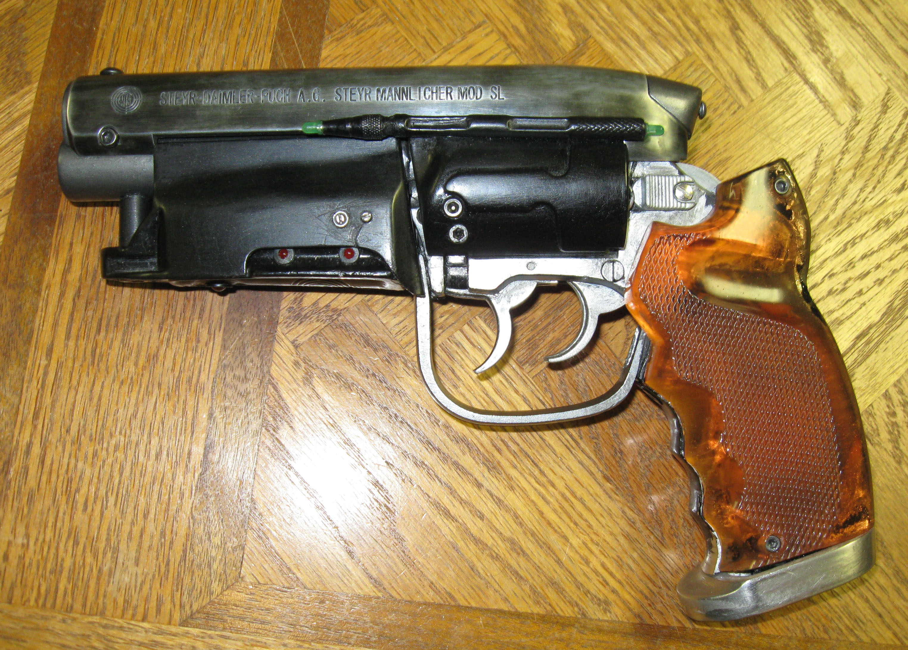

PostPosted: Mon Jun 02, 2014 7:20 pm    Post subject: Metal Grip Frame and but plate Reply with quote
LOL. I love it.
THIS was the first upgrade I did to one of my OFW's (OffWorld)
Yes they fit. The inner handle (.38 ) has some space at the bottom.
the rear and forward holes lines up with the Coyle outer grip frame.
The bottom does not. I used this space for some lead fishing sinkers for added weight.
Here are some examples of OFW's with Coyle Outer grip, amber grips and butt plate:(note, the safety swich is ALSO a Coyle metal safety.
If you do this you need to cut off the OFW safety, sand and paint the aria were the safety was. I super glued it to the reciever instead of drilling a hole as this aria is the weakest part on the OFW receiver and is VERY prone to breaking. I've broke 2 OFW receivers in this area just removing them during disassembly.
http://propsummit.com/upload/949/offworld_coylegripls2.jpg
http://propsummit.com/upload/949/offworld_coylegriprs2.jpg
http://propsummit.com/upload/949/of_coyelgrip_a.jpg
http://propsummit.com/upload/949/of_coyelgrip.jpg

I forgot this or I would have posted it.
I used the OFW metal trigger guard with the Coyle.
If you do this you will need to cut / file a notch to fit the turn down hook up to the outer grip as the Coyle grip is set up for a screw attachment system for the trigger guard.
