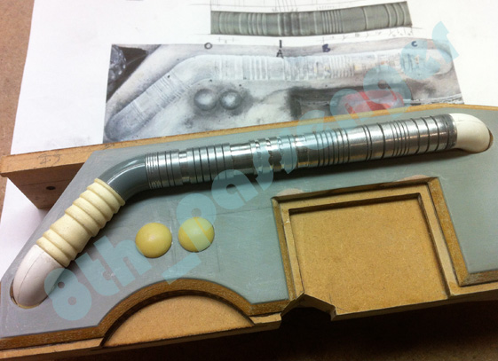

Here's a small update on the flamethrower.

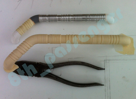

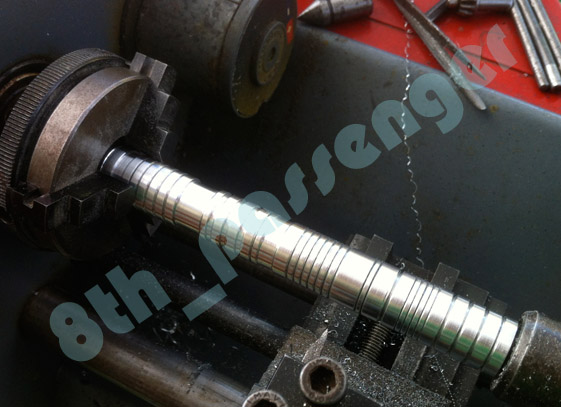

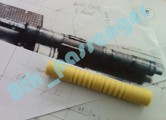

I had chance to turn the rest of the pipe detail on the right hand side.
I'm reasonably happy with it. Just needs a bit of tweaking and then moulding and casting as one piece.
I hope to get back on with the build more seriously soon and I will post updates.
Hopefully it should start coming together as a finished piece over the next few months!
Colin

Joberg, the shapness is the thing I'm thinking of changeing. I may go in a bit deeper with the grooves and then round off the edges.
Colin
Ripley: What's it key on?
Posts: 9465
PostPosted: Sat Feb 28, 2015 8:37 am    Post subject: Reply with quote
Do you think that could keep what you have already and simply put a small bevel on the edges. It could "open" your grooves Wink
Posts: 443
PostPosted: Sat Feb 28, 2015 1:47 pm    Post subject: Reply with quote
yes joberg my plan is to keep it pretty much as it stands now. I was only planing on making the grooves fractionally bigger. Maybe I'll try a needle file first.

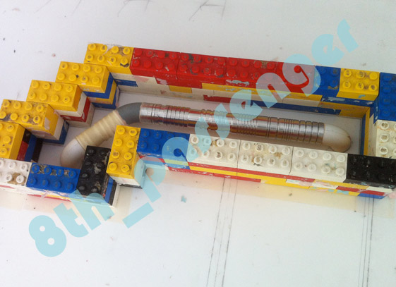

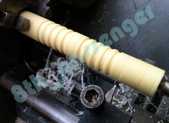

PostPosted: Sun Mar 15, 2015 1:37 pm    Post subject: Reply with quote
I did the adjustments on the turned pipe. I took joberg's suggestion and mostly used a needle file to open up the slots. Worked a treat.

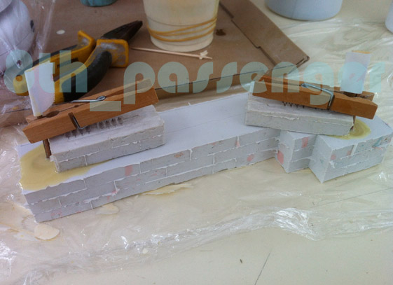

Using my trusty Lego I made a one piece mould.
I cut the mould on the underside, so the seam will not be visible when it gets attached to the body.
I then bent up some 1/8th inch steel rod, to suspend in the mould, to give the piece a bit of extra strength.
The casting came out nice and clean.

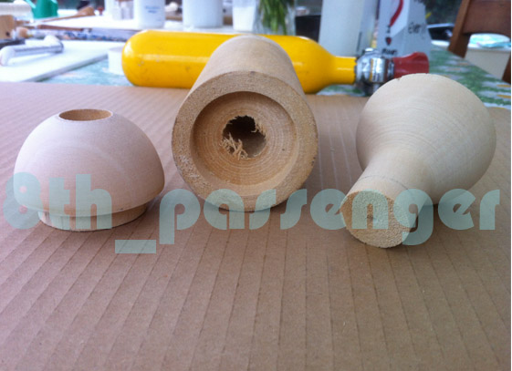

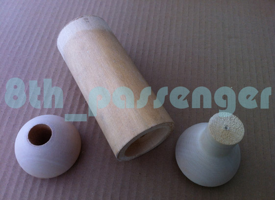

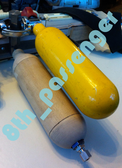

This week I started working on the dummy white tank. Because I need a hole all the way through I decided to make the pattern in sections so I could drill a hole through each section comfortably.
The top section still needs its hole drilling.

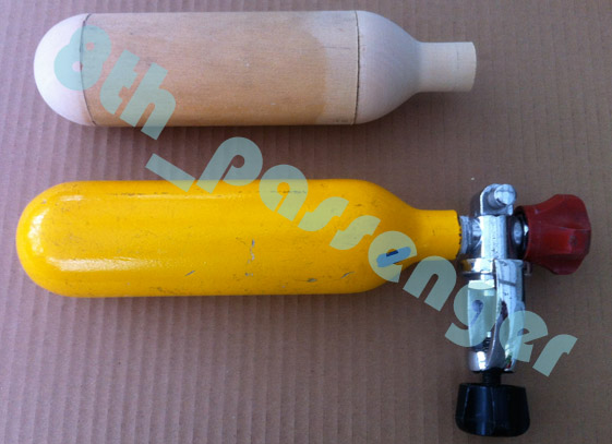

Here's a comparison to my real tank.
I plan on doing a two part glass fibre mould. A piece of hexagonal steel will run through the center of the tank to take the fittings at either end. The final cast will be glass fibre.

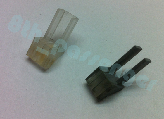

I decided to remake the small detail piece which hooks over one of the Hornby Piers on the right side. The perspex one I had 'pinged' off due to insufficient gluing surface.
I made it again but this time put a web across the base. Rather than gluing on the new perspex one, I moulded it and stuck a fast cast one on. It's still fragile but feels better!
You can see the fast cast one in the second picture.

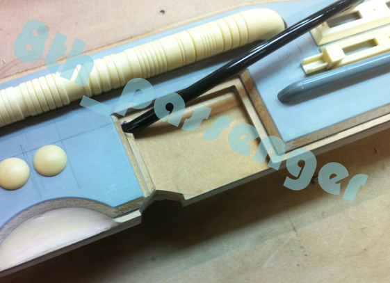

I filled the semi circular cut out on the right side and blended it into my routed edge. Also I drilled the exit hole for the propane pilot flame feed.
Then using some EMA I sketched in the pipe which runs on the forward lower right side.
A wider shot.

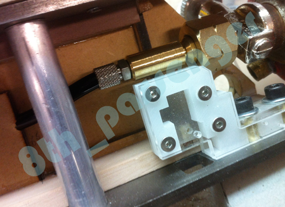

Here's an internal shot showing the polyurethane pipe connecting to the propane bottle. I shortened the turned brass connector I made and notched out the back of the trigger housing for a better fit.
