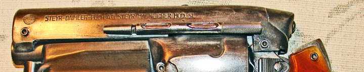

Cool laser. But if you really want to stick it into that "laser" gizmo on the left side, the only way I think you can stabilize its aimpoint is to mount the tube *on the Steyr receiver* just above the Steyr cylinder shroud, not on the shroud itself as is done with the movie prop. You'll never be able to get consistent targeting with it on that thin metal shroud. If your top Steyr receiver is secure-- e.g. you machined it out of steel, and securely attached it to the Bulldog frame strap, you've got a shot *if* you attach the laser thing to the receiver. If your gun is pewter, the snap and transmission of energy through the frame will very likely move the laser's target point each time you pull the trigger. If it's pot metal, you've exchanged soft for brittle-- but it's certainly more dimensionally stable-- might get lucky. If it's resin, you're on the wrong page. It will never work if attached to the left cylinder shroud no matter what it's made of. Every time that gun fires, it "inflates" the cylinder shrouds with gas blown out between the cylinder and barrel. Get it? Pewter guns are common, so let's briefly look at that material. "Pewter" has a lot of formulations, but these guns seems to be the lead and tin variety. It's easy to cast and form, but not that stable. Upper class Romans-- who weren't all that stable either-- used to store acidic wine in pewter, allowing one to guzzle lead along with the wine and become drunk and insane in half the time. (This could very well account for the reason the Emperor Caligula was such a fruitcake.)
Check out the pics of my PKD (having sent three 200 grain chunks of lead down its pipe, it's a You Tube verified shooter). If I didn't tell you the laser thing was attached to the receiver, you'd probably never notice. My gun has a lot of other cosmetic problems, but it's still a work in progress. I also committed the sacrilege of shortening the gun by half an inch so I could stick with a factory barrel (4" as opposed to aprx. 4.5 breech to muzzle on the movie prop). The PKD laser is held in with two 4-40 steel screws with the heads mostly filed down, and also soldered.
Now, Plan B. Since you have enough room to swim in under the Steyr receiver shroud-- I suppose depending upon how you machined it-- with that $200 green micro laser all you'd need to do is drill a hole in the center of the thing that sticks out of the front receiver barrel plug large enough to clear the beam, and mount the laser to the barrel via your custom machined laser adjustment housing. That will definitely work, assuming your laser is rated for the high impact it's gonna get from a .44 round, and you make a good solid barrel mount for the laser.
What I'm going to do on my funky gun is stick a small 2nd generation Laserlyte FSM (1.75" x .55", .9 oz, designed for guns and costs fifty bucks new if you shop around) on the top rail of the 4" Bulldog barrel, and aim it through the middle of that center hole I mentioned previously. I probably won't bother to install the center thing (it may be part of the real Steyr's firing pin assembly-- dunno for sure) in the receiver plug. This leave a nice large hole that will accommodate any wiggle of the pewter Steyr receiver shroud I used to build this less than $700 gun (used Bulldog and extra barrel included!)

Now here's one hell of a fine job attaching the PKD laser sight to the swingout cylinder shroud. Rock solid. However you do need to know that on this gun all the steel is either custom machined or modified from an actual Steyr rifle receiver. The parts fitting is superb, the gun is as solid as a rock with a very innovative front cylinder lock system that allows you to remove most of the ejector rod and swing out the cylinder just using the Bulldog cylinder release (and you don't need to remove the Steyr magazine.)
But does the above contradict my opinions on putting a real laser on the swing out shroud? No. The sight on this gun is decorative. No real laser inside. Still, it's true to the prop design, which didn't have a real laser either.
