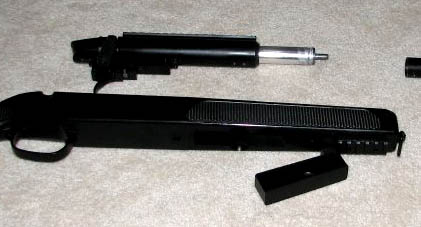

The second problem is gutting that UTG sniper rifle. While the exterior does resemble the steyr, while the stock is attached, once it's off you notice this:
Unlike the real steel gun, the airsoft rifle is closed along the bottom of the receiver. That's going to have to be cutaway, or milled away.
And you don't get the magazine or magazine housing either. You gotta buy those elsewhere, somehow, nobody makes and sells just the mag and housing.

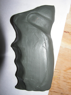

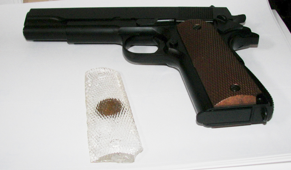

I think I take your point about the Bulldog's frame; I'll just have to find a way around the problem when a revolver materializes. In the meantime, here's a couple pics of my first grip casting experiment. I used liquid latex to take a mold from my 1911 and poured polyester resin. The penny is embedded because I failed to mix a proper amount of resin so since I had to pause and mix up some more I decided to throw something in there and the penny was nearby, so....Anyway, I learned alot abou the process so now I'll start sculpting some grips in plasticine. Also, some pics showing the UTG receiver on a scale printout of one of Karl's pics. Here you can see the ejection port and consequently receiver length are clearly oversized, but I have a deranged plan to deal with that, of course....onward, and crazyward...

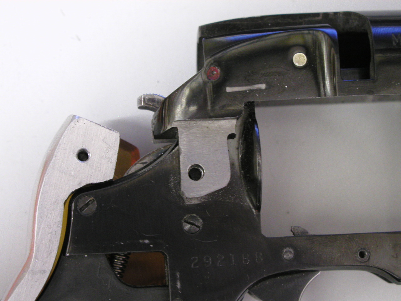

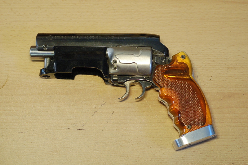

| Quote: | Tell me about your picture; is that a real Bulldog in a homemade blaster? The back strap of the grip looks like it was cut by hand...
Yes, it is my real steel blaster which I am working on. The bulldog is modified as "LEP" gun to make it legal. LEP = Airgun. You can load the cylinder with air-compressed special bullets, so the function is still alive.
The alu grip frame & butt plate are indeed done by hand.
Here are some images :
I finished the Steyr receiver end cap but it`s not on the image yet.

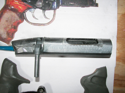

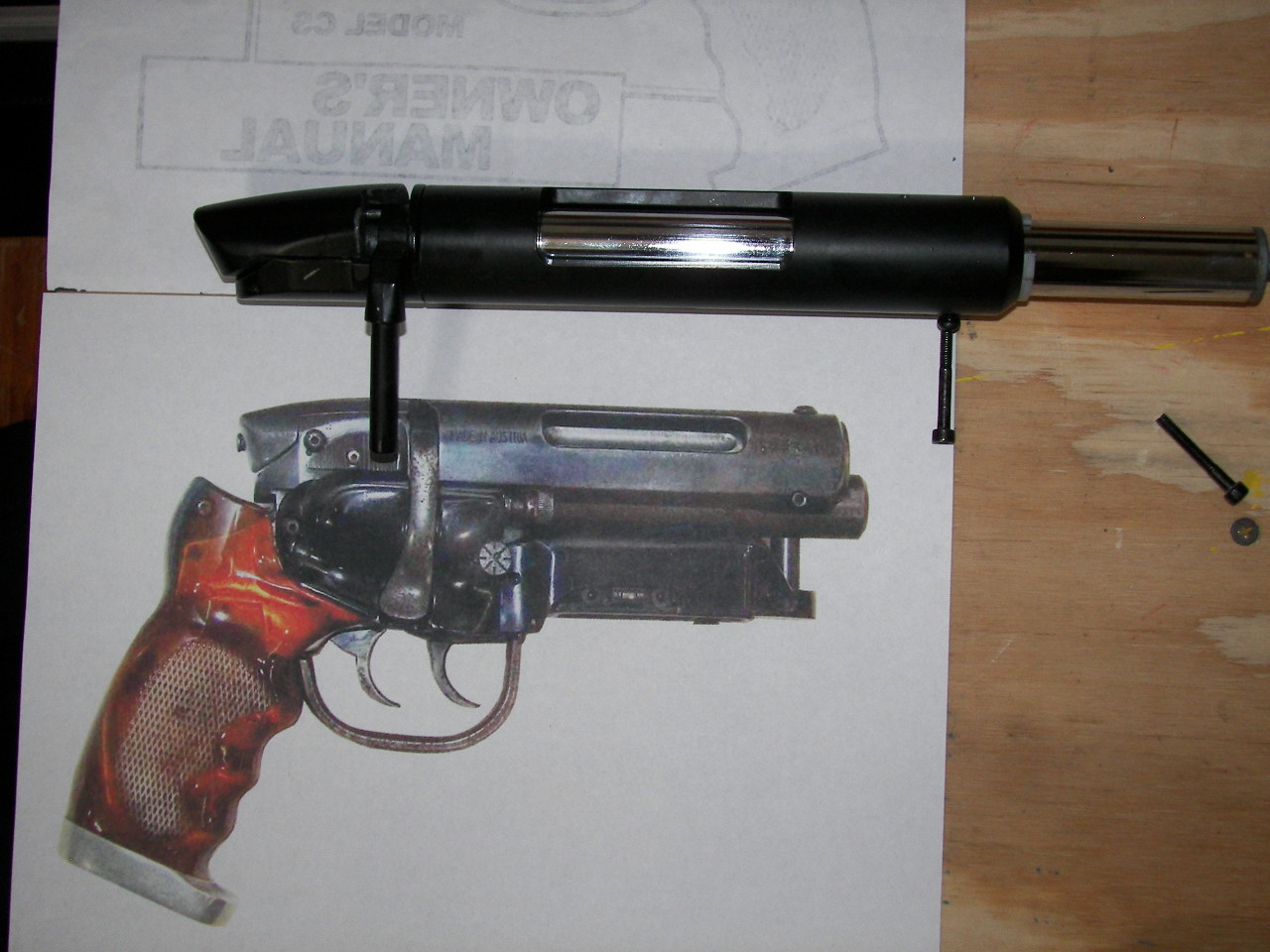

Well, my scratch built blaster inches towards more completeness...still lacking a suitable revolver, but i have faith something will turn up. I've cut the UTG receiver down and roughly squared up it's sides (it was perfectly cylindrical to begin with). Then I plugged the ejection port, which was far too big, with some 1" galvanized pipe and cut a more Steyr-like ejection port. I had thought the great big port would look cool but it looked crappy compared to the original .223 port. I'm now taking a little material off the rear cap, which is a tad pointier than the Steyr's, and beginning to shape the "muzzle".

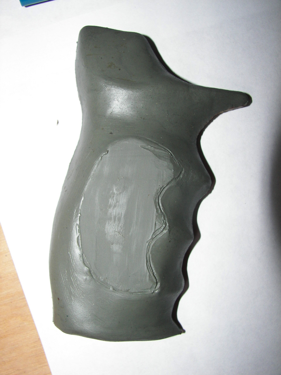

I'm nearly done with the clay models for the grips, but I'm having trouble sourcing large, flat expanses of diamond pattern without screw holes to copy...I think I remember reading Rich had the same problem. I'm waiting on some resin casts I took from the UTG stock to cure now; we'll see if they solve that problem...
Also in the pics you can see the quick release lever I took from an old bike seat post; I'm hoping to convert it to a cocking lever, of course...yeah, a little too muich time on my hands...
