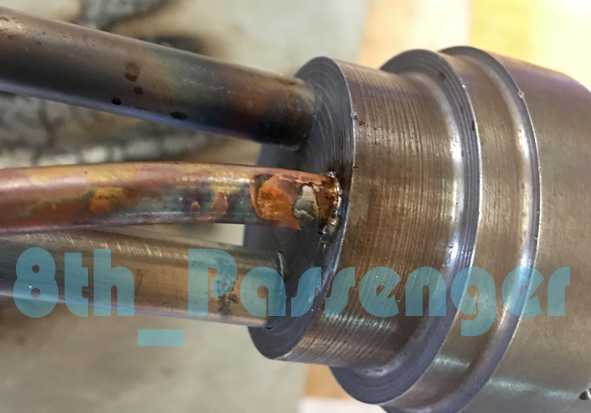

I heat treated the emitter to give it some colour.

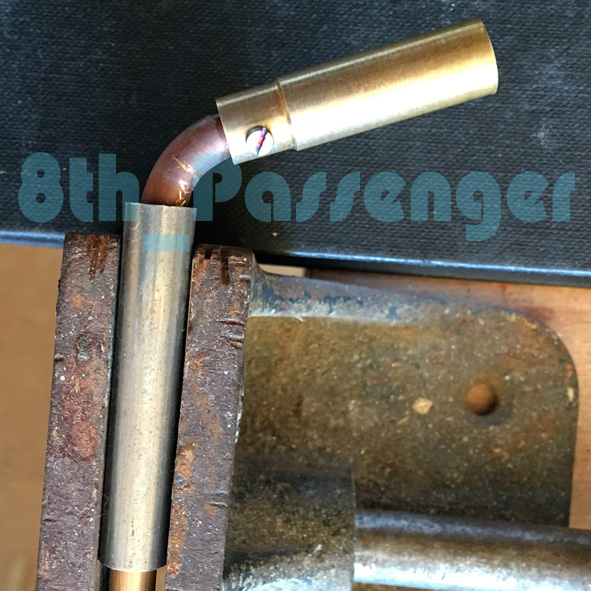

I bent the feed pipe for the pilot flame.
There is not really enough room to get the bends I needed. I wish I had bored out the emitter a bit deeper.
I used a bit of steel pipe to help bend it after annealing the copper tube.
It took me two attempts as I realized I'd cut my original copper pipe too short.
These are the first two bends.
It didn't quite work out like this!
But I got it to bend in the right places in the end.

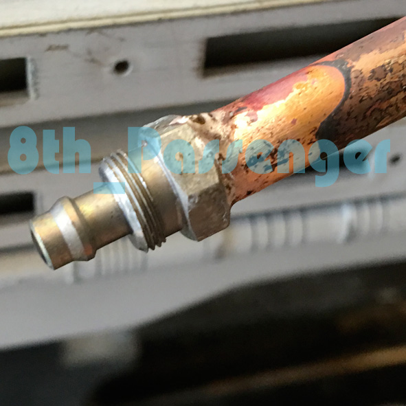

I had to re-drill and tap the end of the copper pipe whist in position on the unit. Because it was now bent I couldn't remove it.
Also I realised, when test fitting it, I would have to solder it in position to stop it unscrewing when connecting the neoprene feed (Its soldered on the actual units).
I thought I should solder the fitting at the other end too.
I soft soldered the copper tube where it enters the rear of the emitter to stop it slipping backwards or forwards.

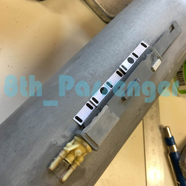

Apart from the spark plug cap I still have to make one more thing which are some extra details for the white tank. They go here. I hope to get them laser cut this week.

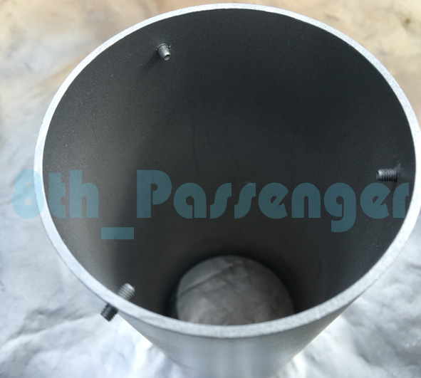

But I went for another idea which was to put three grub screws at the end of the tube to lock and center the bottle.
I think some shorter grub screws may be in order.

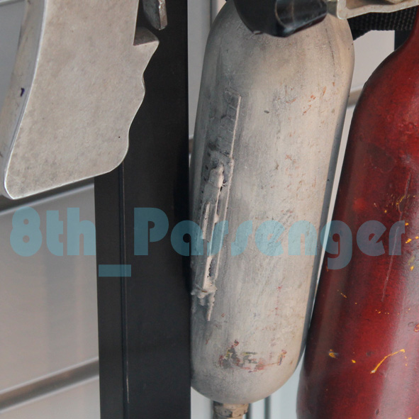

Whilst gluing the detail on the white tank today I noticed I had a decision to make.
Where did I want the 'tank detail' to lie when the tank was screwed fully in position.
Here it lies at the back
Here it faces out from the left side.
I decided this probably wasn't the best position for it as it may get broken off being against the body.
So I've opted for this position.

I got the missing detail parts for the white tank laser cut.
Now I just have to fit them.

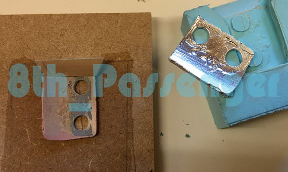

So I had to create a mock weld/wedge to take up the gaps at either side of the tube where it joins the grip frame.

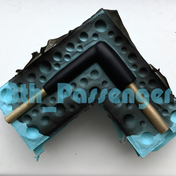

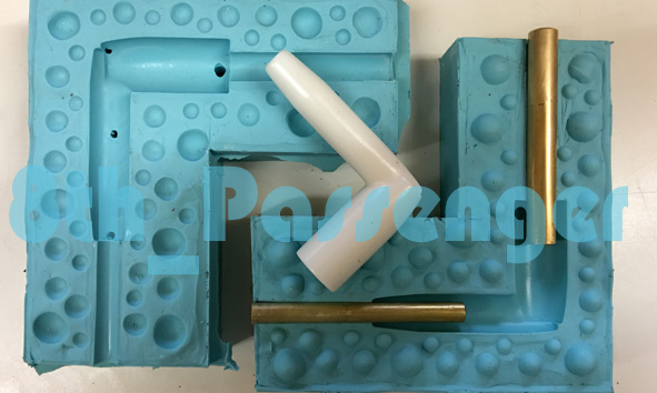

I made this by using some filler on a base of styrene. I then moulded it and cast it in white metal, to give it some strength.

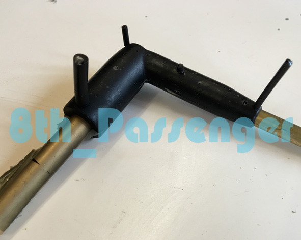

I moulded my spark plug cap in silicone in the end. Mainly because it was quicker and a fact-cast one would be okay for the photographs.
But I also managed to get hold of some urethane rubber so I cast one up in that too.
Its probably not as ridged as a vulcanized rubber but it wont snap off like the fast cast one if it gets knocked.
A few air bubbles but not a bad first attempt.

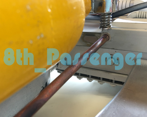

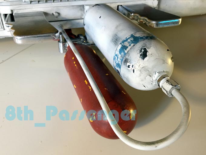

I decided the entry hole for the feed from the bottom of the white tank should be in the underside of the body rather than connecting to the yoke on the red bottle.
I drilled a hole and turned a little insert for the tube to locate into.

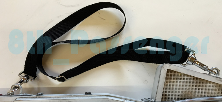

I hand stitched the fittings I got to make up the sling. I went for 25mm black webbbing but 38mm may have been more comfortable. I think I can improve on this later.
As the whole unit weighs 17 pound or so a leather strap my be more hard wearing!

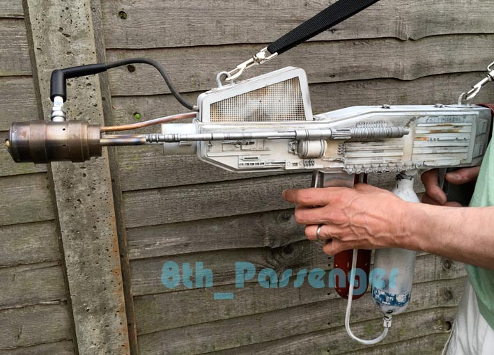

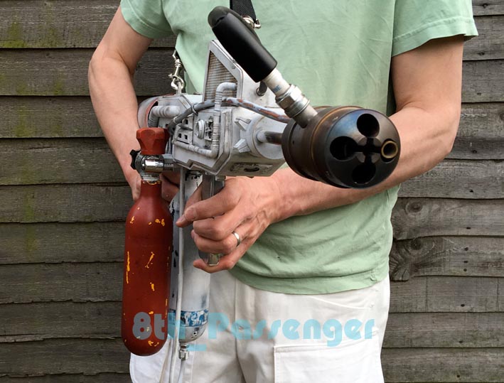

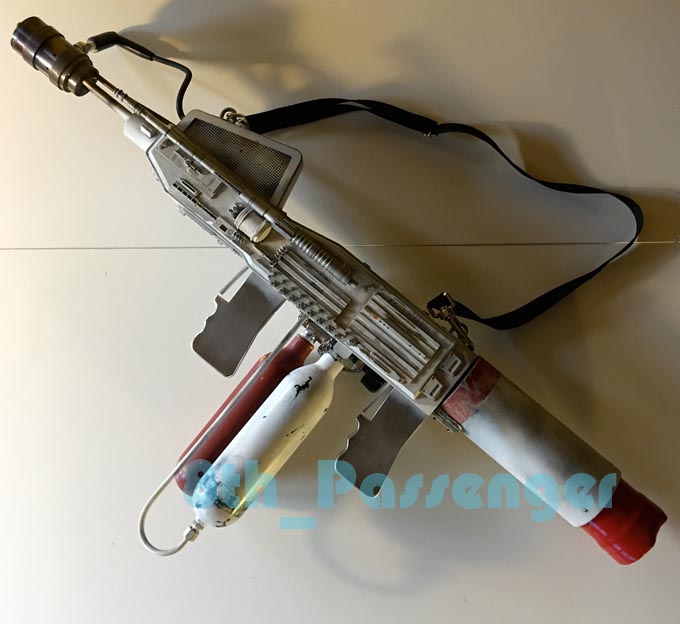

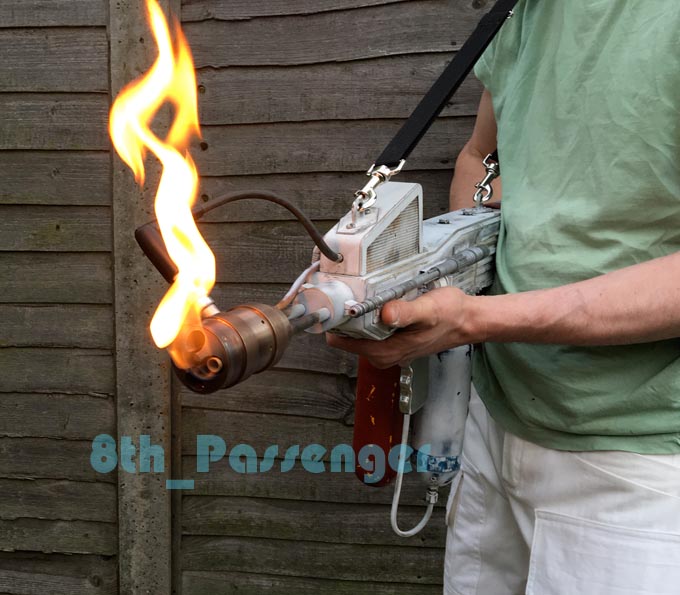

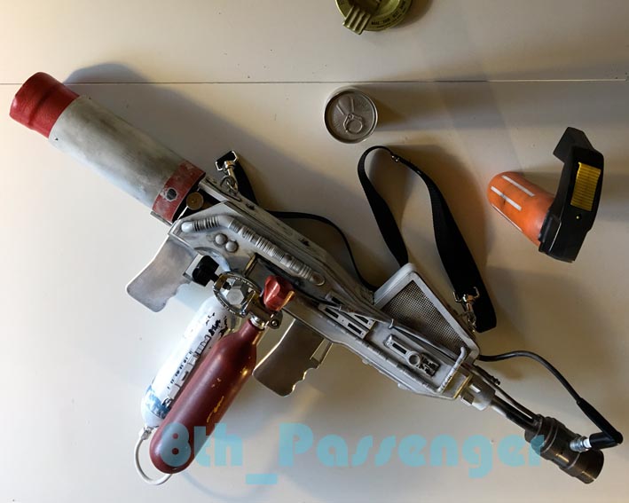

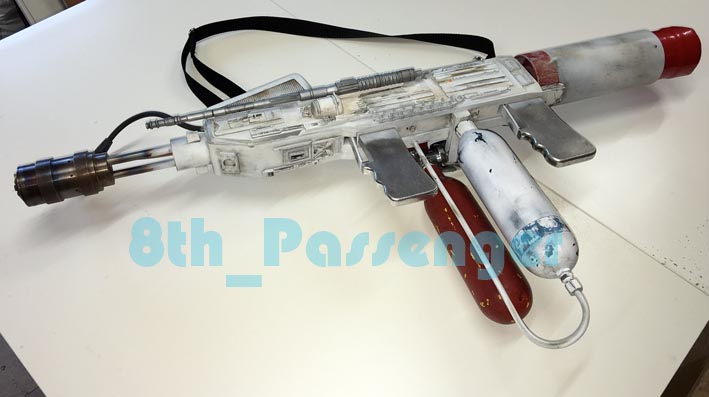

Finished (finally!) Very Happy
At some point I hope to take some better photographs in a more Nostromo like interior.
But for now two Ikea tables and a garden fence will have to do....
Colin Very Happy Very Happy

Holy fuck! That is crazy awesome!!! WOW Shocked Shocked Shocked
Nice job, Sir!

It really is just perfect. Even the flame is dead on. This is definitely up there in best prop builds of all time.

It's perfect!
I salute your skills and patience.

TOTALLY BLOWN AWAY BY THE END RESULT, BRAVO COLIN !
(use it next time you'll have to start a barbecue !)

That prop is A+ in my book: the paint job is Pro Cool Just noticed that the pilot flame is close to your rubber plug (better in the end for the wear & tear look)!
Love the uniform also...and the wooden fence Great job and very cool result!!!

The spark plug cap in the picture with the flame is painted fast cast. It almost got slightly cooked.
