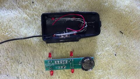

Hey everyone!..So I have an Off World M2019 and only the red LED lights work!?..I want to wire up some 3mm green LED's in place of the dummies they have there and wire them to the housing where the on off switch is ...basically using the green board in there to power the new lights! Has anyone else done this and if so can you tell me what type of capacitors I need etc...any help would be greatly appreciated! Thanks....

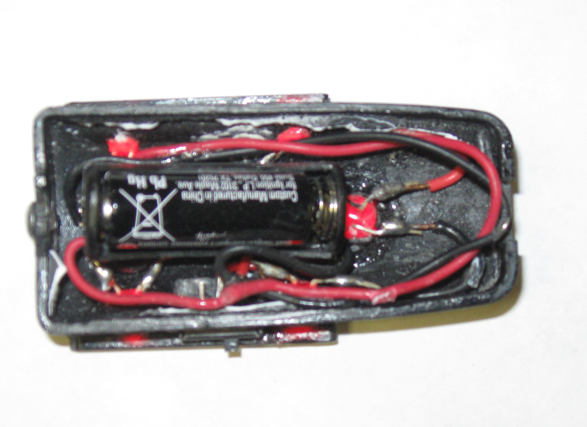

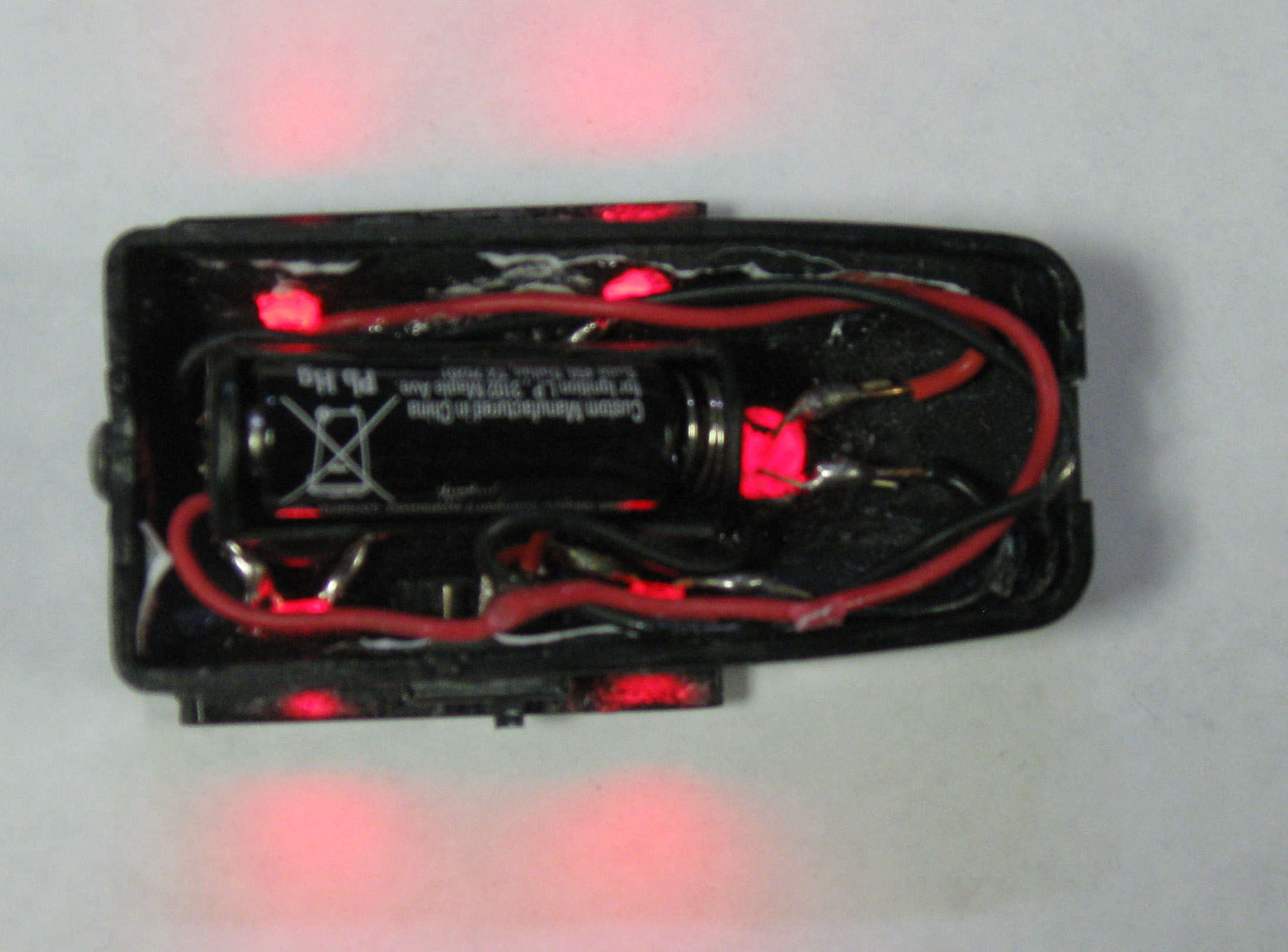

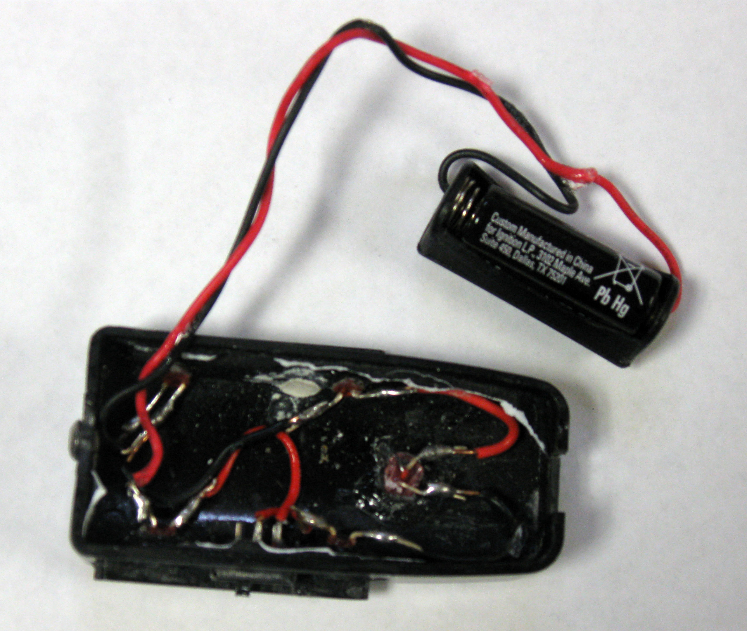

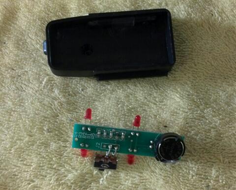

These are designed this way. In the movie, the green LED's never light up.
Having attempted this "conversion" myself, I would recommend replacing the OffWorld site rod with a metal version. Trying to drill out the plastic just destroys it.
The OffWorld red LED board doesn't support adding more LED's as the board burns out.
If you MUST do this you will probably need to rewire the whole set up.
You can use the OffWorld ammo cover as your housing, replacing all the red LED's and adding the green LED's. You will need to solder all the LED's the "old fashioned"way (no board) and a 23A battery.

See Rich Coyle's instructions on how to wire it using his diagram as a base. Or use the SID or RR kit instructions for the red LED's and Rich's green LED instructions.
You can buy all the LED's and everything else you will need from Radio Shack. They sell a pack of 3mm and 5mm various color LED's for less than $5.00. and a mini solder kit for $10.00.
It will take you about 2-3 hours to complete and test everything.
If you do not know how to solder,(I did not) watch some clips on same on U-tube
OR if Rich has any of his pre wired Ammo housing kits for his blasters still for sale BUY IT. It will fit an OffWorld. I test fit one on an OffWorld.

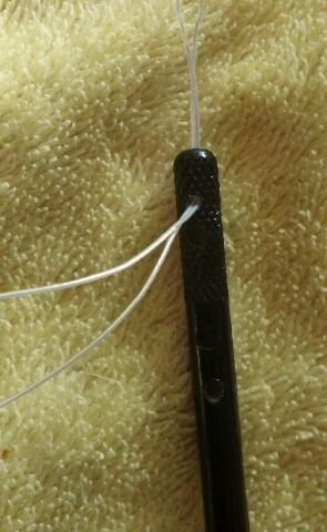

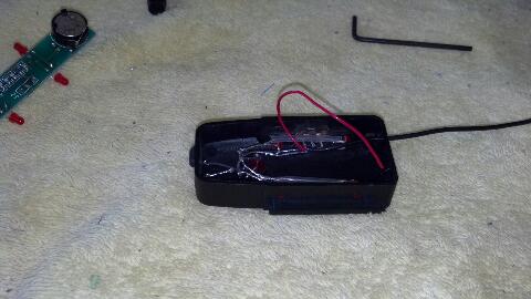

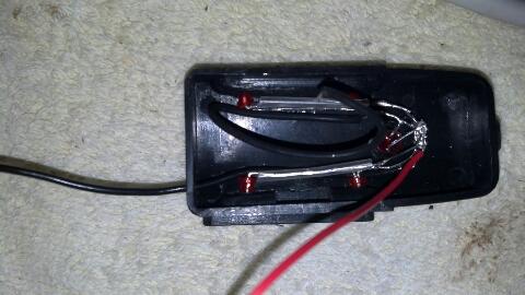

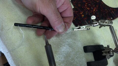

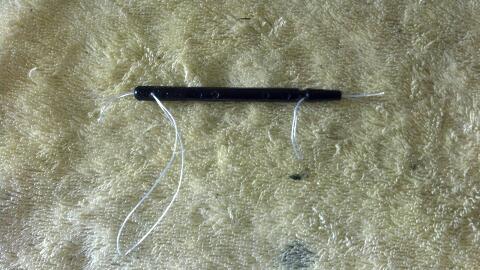

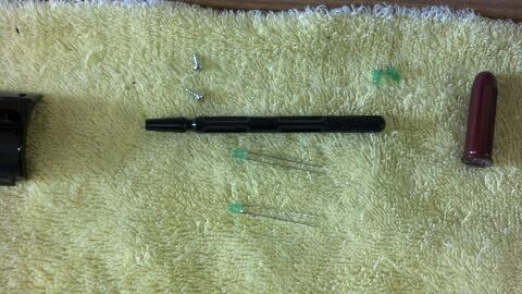

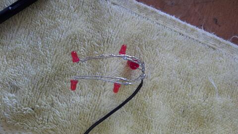

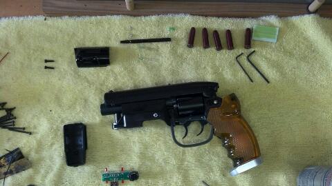

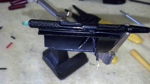

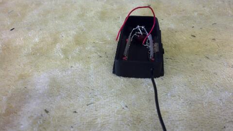

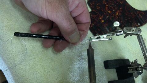

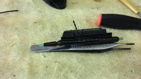

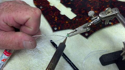

OK!...I have officially started my Off World modifications... I used a drill press and a heavy vice grip to hold the sight arm in place. Then slowly I drilled out the front and back piece where the bulbs are...after that I used a Fordham drill to drill side holes in the arm so the wires can come out.
Next I soldered the green LED's to the wires and CAREFULLY slid them through the drilled holes. I had to bend the wires ever so lightly to get them to make the 90° turn to exit the sight arm.
After that I put the arm back on the plate and that's about as far as I've gotten yet...here are some pics...I will be rewiring the LED's next.

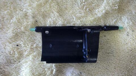

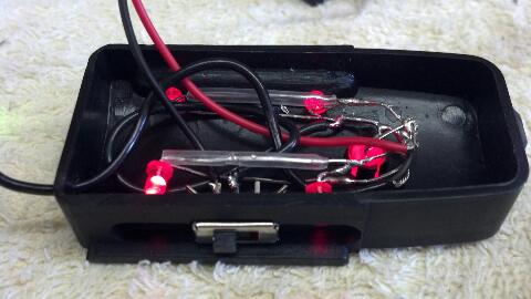

http://propsummit.com/upload/index.php?file=off_world_mod_finished.jpg[/img]
Here are the final stages of the modification....
