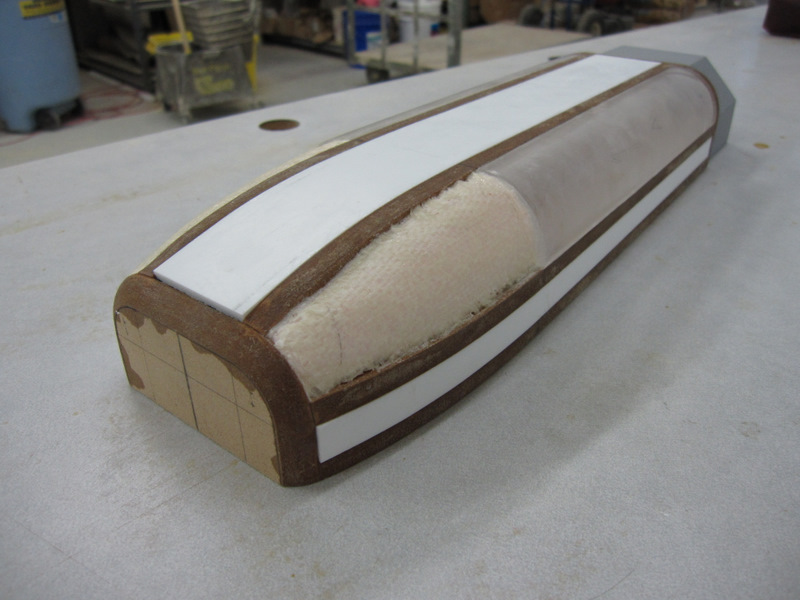

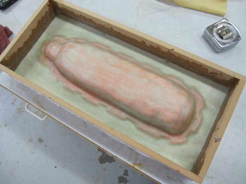

I started with the engine pods. This is the pattern for the mold, made from MDF, acrylic tube, styrene sheet, and carved foam finished with bondo. I'll laminate four of these and get two top and two bottom halves of the engines. I deliberately left the pattern light on detail. I'll add more to the cast parts later on so the engines have more of a distinct left/right look.

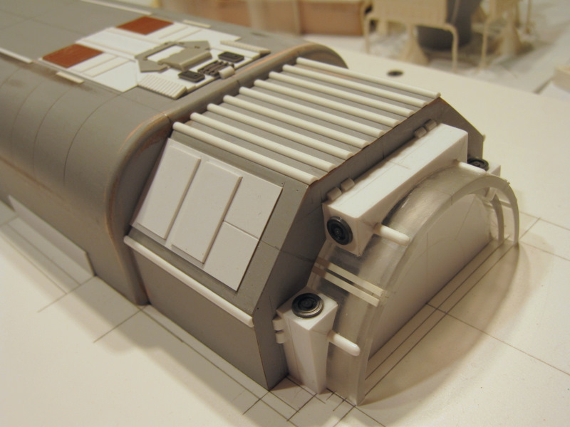

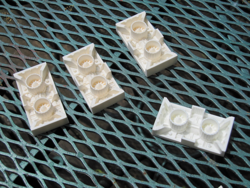

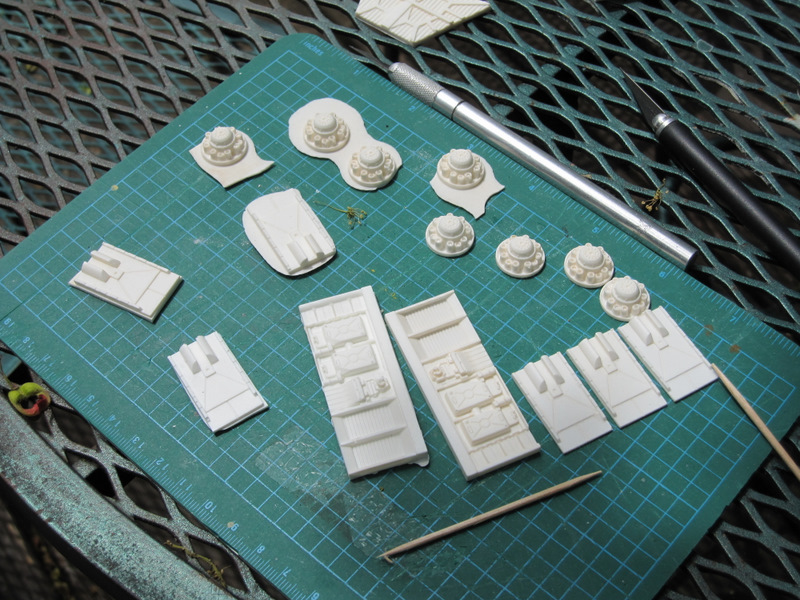

Here are some detail parts cast from resin out of silicone molds, thrusters and such. See if you can name the greeblies. Also a quick mock-up the rear end to see how the details look together. The cast resin thrust vectoring baffles (or whatever) are still on their sprues. Cobb's illustration shows only a front/side angle so I'm cheating a little bit on the stern and making the details look much more Nostromo-ish back there.

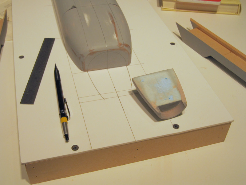

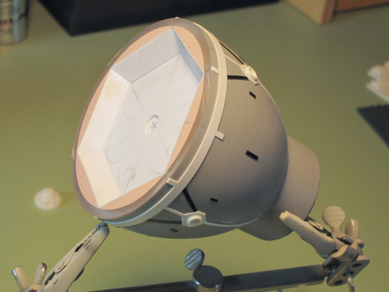

Here are some more pictures: the pattern for the main thrusters is ready for molding. And here is the frame of the main body starting to come together. It is basically a series of boxes attached together. I know its hard to see whats going on here- I tried to photograph the same angle shown in Ron Cobb's drawing.
As mentioned before the materials used are MDF, acrylic tube, sheet styrene, bondo, and various kit geegaws (tanks, ships, old Star Wars kits). The black strips on the thruster are made of Dymo lable tape. Its faster than gluing styrene because the pieces only have to stay on the pattern long enough to mold and I don't need them to be durable. Quick and easy.
