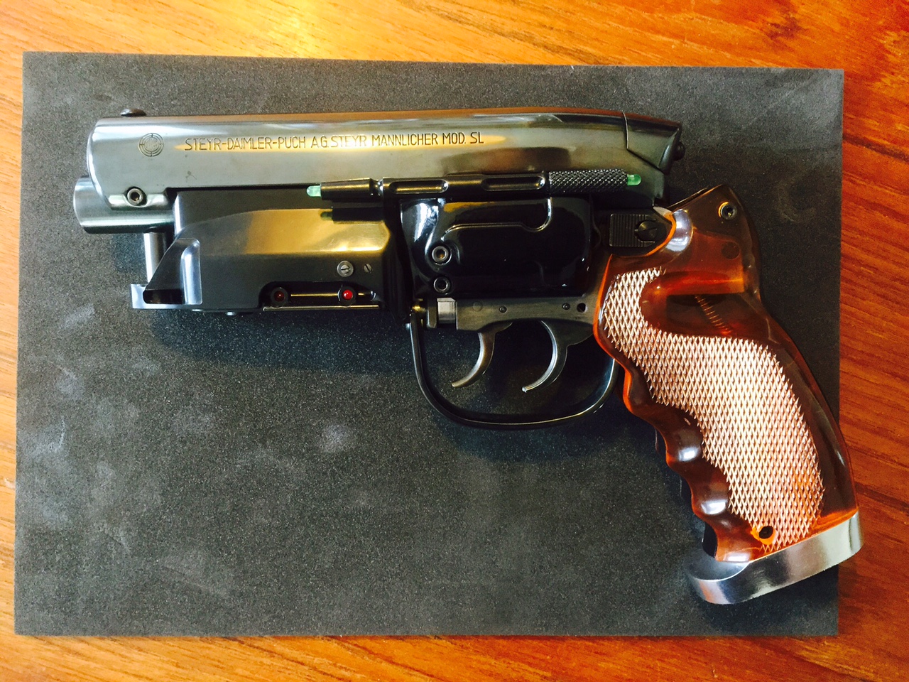

My finished Tomenosuke kit from latest run
Posts: 1184
PostPosted: Wed Jul 29, 2015 8:30 am    Post subject: My finished Tomenosuke kit from latest run Reply with quote
Hi guys...

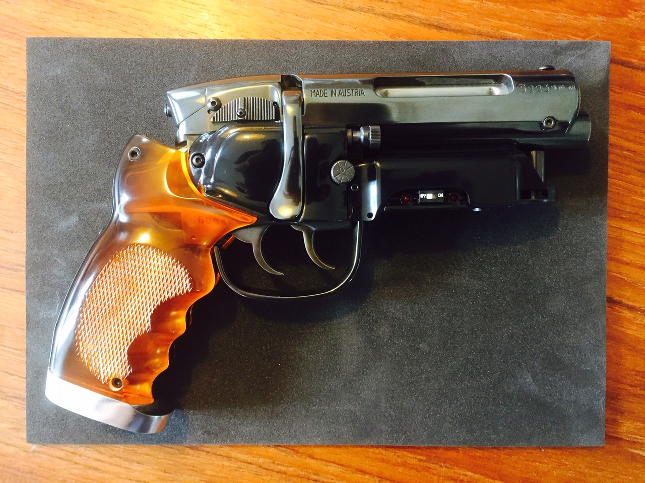

Just wanted to share with you a few snapshots of my newly finished Tomenosuke kit... It's been almost a year in the making!
The bluing is THE single most difficult thing I've ever tried Confused And this is the fourth and final version which I'm quite happy with Very Happy
Contrary to what the pictures show, the metal parts are pretty dark grey/blue. The light color is due to the shine. That's the everlasting story of how light can cheat our eyes...
I've gone with the... let's say "generic Blade Runner blaster" look
I wanted this to have the weaver knob because I already have one of Rich's beautiful blasters in my collection with the slotted screw...
What do you think?
EDIT:
This is the full guide to to bluing process...
This work requires safety equipment: Safety glasses, gloves and respirator mask. And should be done in a heavily ventilated room or outside. Here are the steps I took...
1. Sanding, sanding, sanding, going from grid 600 til 1200.
2. Finished sanding process with Liberon steel wool grade 0000. Put some effort into this phase, the smoother the surface, the better the bluing fluid adheres.
3. One thing I learned at this stage: Whatever you do, DO NOT TOUCH the receiver from this point on with anything else than clean paper towels!! Not even with the rubber gloves. Even the tiniest stains will effect the final result.
4. Clean the receiver with acetone.
5. Rub receiver with clean and dry paper towels.
6. Apply Birchwood Casey Perma Blue (concentrated liquid) with cotton pads evenly all over the receiver.
7. Rub receiver with clean and dry paper towels.
8. If you get smudges (you will!), rub the smudges with cotton pads (with bluing fluid on), then directly thereafter rub off the bluing fluid with paper towel. Repeat this stage til you get an even finish.
9. Seal the parts in acid free oil (I had them soaking for 3 days).
10. Polish with wax, for instance Renaissance Wax.
11. Buff with polishing cloth (for jewelry).

Beardybloke
Joined: 30 Jan 2015
Posts: 180
Location: Plymouth,uk
PostPosted: Wed Jul 29, 2015 9:45 am    Post subject: Reply with quote
Ooh yeah that's what I call a blaster Buch, it's so shiny you could see yourself in it, in fact we can see you in it 😀

I especially like what you did to the grips,what is it in the checkering is it brasso or just standard car polish
Tell him I'm eating..
Posts: 1184
PostPosted: Fri Jul 31, 2015 3:00 pm    Post subject: Reply with quote
First I polished them with some cheap, standard aluminium polishing paste and a buffing wheel... Then hand polishing with Brasso...
