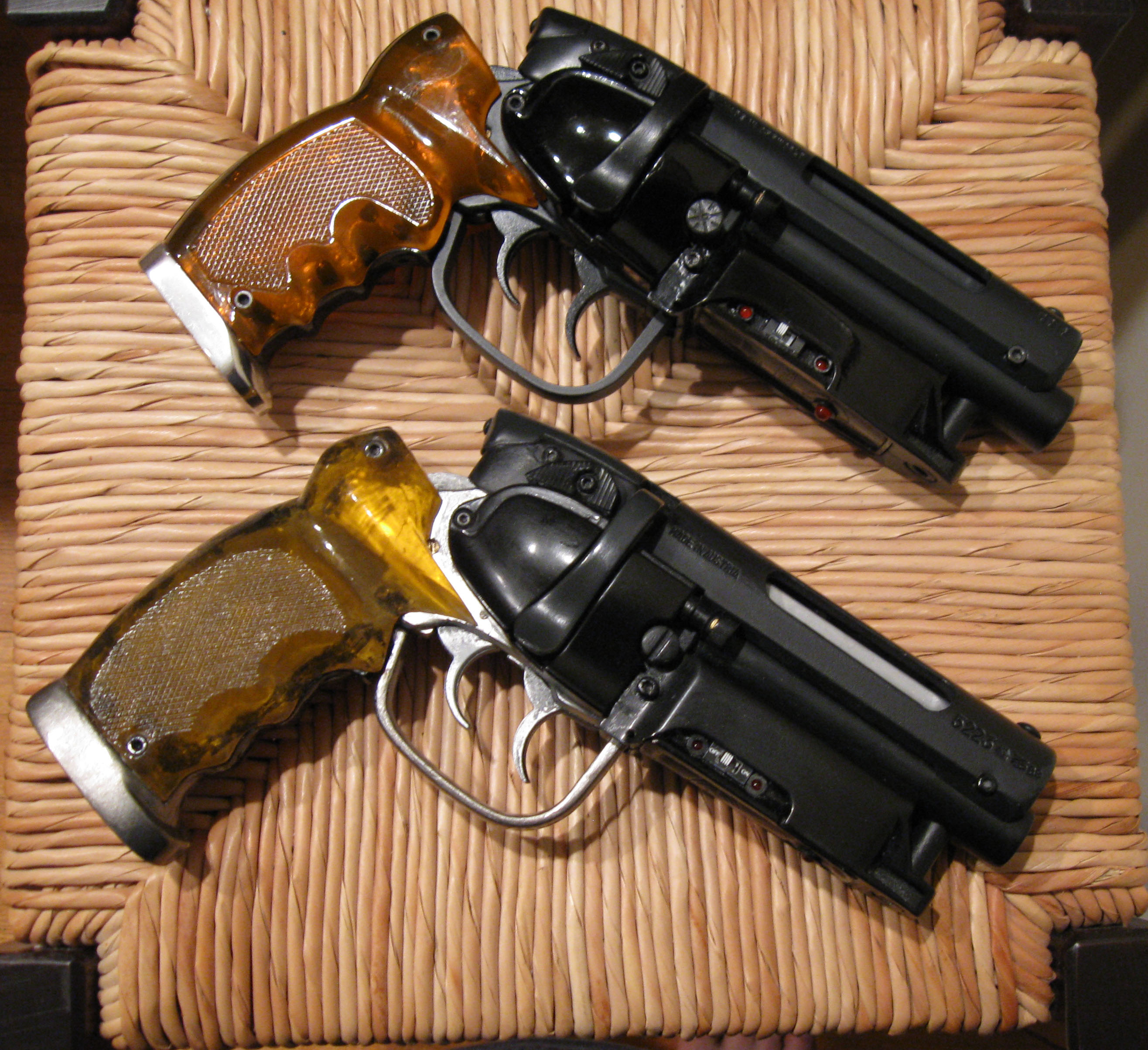

Here is an example. One is an Offworld and one (bottom blaster)is an Offworld with the RR Grips.
http://propsummit.com/upload/949/img_0290.jpg
Hope this helps and is not "too much info".
Best of luck!
