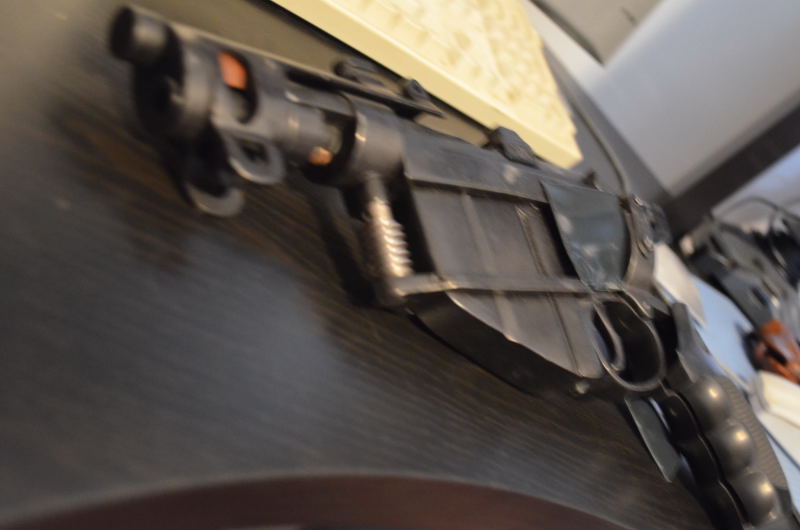

yeah, I thought (my 2 cents) that leaving the mechanism open (maybe a LED in there) could've been interesting...since gases from the shot will not sever your fingers

now for pics, someone mentioned doing a carbine version so i snapped a pic of what that might look like
Here it is with the side covers painted, and the barrel assembly screwed on I hate tapping and I'm not entirely happy with how it sits. I also attempted to stain the mdf and I think I might paint it instead and add some metal appliqué.

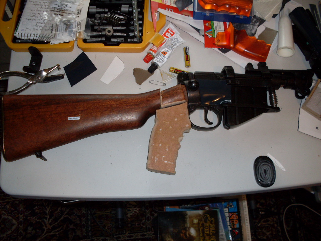

been a long time since I've posted, I hate how life gets in the way of my hobbies. I've altered the grip a bit more, and shaved down the the section of the stock that sits on top of the grip. I'm having an issue however, with affixing the grip to the pistol itself I attempted to screw it on. I noticed that even though I pre drilled the grip it was splitting the grip. So, my question to the board; How can I attach the grip securely enough that it wont snap off with handling?
full tilt boogie baby
PostPosted: Sun Mar 20, 2011 3:36 am    Post subject: Reply with quote
Is the grip beyond repair? Can you post some pictures of the damage?
My first thought would be to attach it using some sort of epoxy putty so you can blend the woods together You will want to roughen the surfaces that will attach to the putty with 60grit sand paper. Once the putty cures and sets, you can blend it all together with higher grit sand paper so there are no seams.

If you're not using solid wood it's going to be difficult not to split the grip (I had to see your previous post to see where you'll be able to attach it)
If you're using MDF you have to be sure to put a clamp around the grip before drilling anything in it and when you do screw something you'll have to keep the grip clamped again to make sure it doesn't split open (make sure that there's no wood/dust residue inside the hole also!)
To have a good tight fit, you could also dip your screw in white carpenter glue...good luck.

Thanks for the tip. I'll have to give that a shot, I was also thinking about putting some two-part epoxy where the grip and gun meet up, just for some extra adhesion.

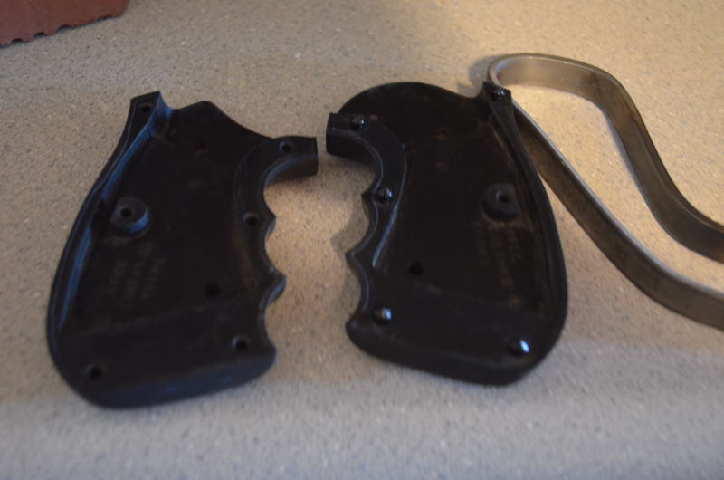

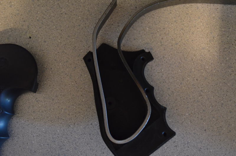

I cant believe I left this on the shelf for so long. I guess life and move across country has a way of putting things on the back burner. Well, I recently decided to finally finish this thing. I had the idea to try and salvage the MDF wood grip, with first some wood grain contact paper then a textured black. The more I looked at it the more I didn't like it so I decided to scrap the whole grip and start from scratch.
I found some decent used Pachmayr rubber grips at a surplus store and decided to make those work. I then made a trip to the hardware store for a "1/2 strip of mild steel. Then the fun began, a few hours of bending and I came away with a rough pistol grip shape that would fit inside the rubber grips. Some cutting and massaging later I had a grip frame i felt would work well.
I showed it to a friend of mine and he asked to use it in a film project he's working on. So, I shipped it out yesterday. I unfortunately don't have completed photos of it handy. But it looks a bit better than it does in the "mockup" photos I have posted.
