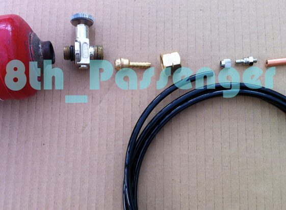

Gas and air threads are not my forte but I'm getting to grips with them.

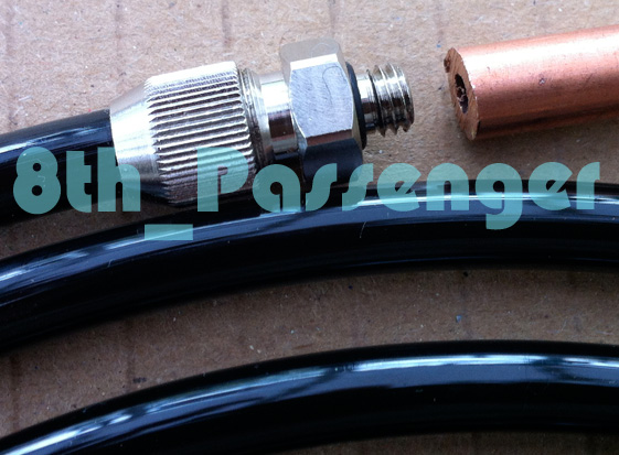

I finally got a reducer that fits the thread on my propane gas bottle. luckily they are still in use.
I also got a fitting that connects the plastic pipe to the copper tube (the outside feed from the propane bottle). The closest I could find was an airbrush fitting (which I bought).

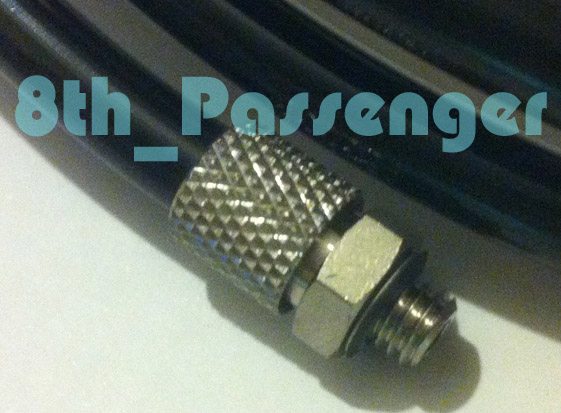

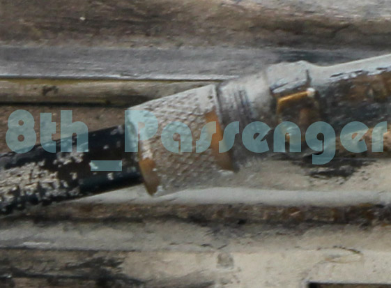

But once I new what I was looking for I found an alternative which has a more accurate knurling pattern on (which I need to buy). The copper pipe needs to be soldered to the threaded end of the fitting!
So it lays out something like this.
There are still issues with the connections to the propane bottle that I need to resolve.
Part of me would like the pilot to work but it needs to be safe.

Master Blaster I found the correct threaded fitting. BSP 3/8" left hand thread. The description says it has a 4mm tail but its more like 6mm (just short of 7mm at its widest point) with an internal bore of 3mm.
The black tube I have is 6mm with a 4mm bore. The tube is not that flexible being polyurethane so I may need a bit of heat to soften it to connect it to the tail.
There may be a different connector I can find so I don't have to heat the tube,
Also I could turn the brass tail down in a lathe.

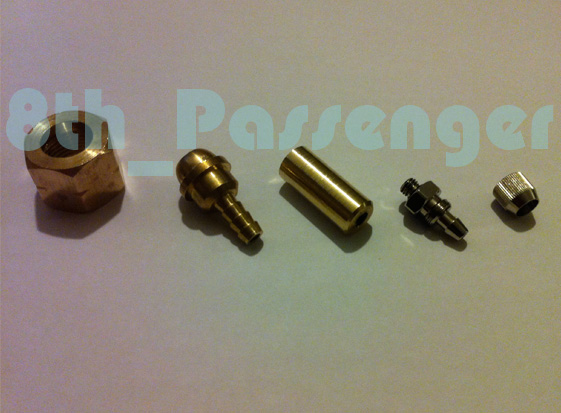

Time for another quick update.
I bought the fitting to replace the air brush fitting. A better match I think. Not exact but closer. Maybe I could turn smooth ends on either ends of the knurling.
I also bought the fittings I need for the white tank. Again these are ballpark estimations judged against printed out photos of the tank at 1:1.
I bought the relative taps too.

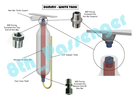

I will turn up the tank shape then fit the fittings in position.
I'll then mould the whole thing as one.
When I do the cast I'll lay the real fittings in the mould. They will be screwed into either end of some hexagonal bar running through the tank.
This will keep them in position and hopefully give it a more realistic weight.
This way there is no way it can spin once the fast cast is around it. I can lock-tight the fitting into the end of the hexagonal bar.
So it will look something like this.
The double ended fitting will be fixed into the hex bar which is attached the the internal frame. This then allows me to remove the tank from the main unit.
That's the plan!

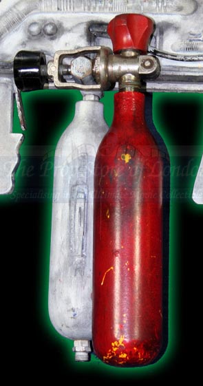

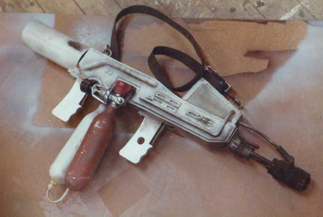

Here's a few interesting things about the White Tank!
It looks like the top has been shortened on some units. Or maybe it's just the one Propstore used to have. I assume all the tanks were interchangeable for refilling so got swapped around.
We can see it best in these photo's of Harry Harris'. Note how the neck of the white tank is about half the length of the neck of the red tank. This raises the white tank 'up' so the fitting on the bottom of the white tank is is almost level with the bottom of the red tank.
A bit more obvious on this Propstore image.
But here on the Pat Lowery photograph the bottom of the two tanks look more level.
And again here on this picture of the fireing version Dallas uses.
I assume different makes of tank/bottle could be slightly different sizes.
Which style do I choose?
Also the fitting on the bottom suggests the contents of the tank exit the tank through the copper tube on the bottom and then up into the main unit. So is the top of the white tank blanked off!

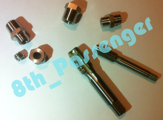

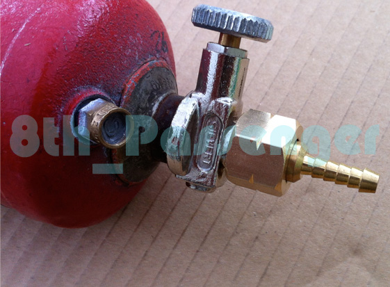

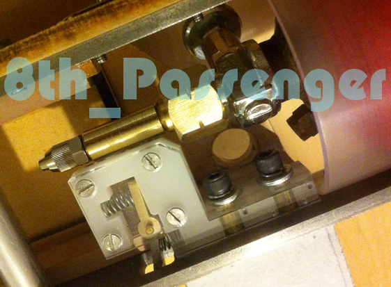

Here's an update on the build.
Before I get back on with the body I need to resolve issues I have with the gas/pipe fittings I've recently bought.

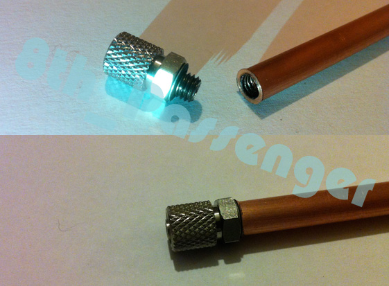

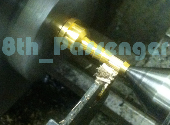

I turned down the brass tail fitting which connects to the valve to make it a bit shorter.

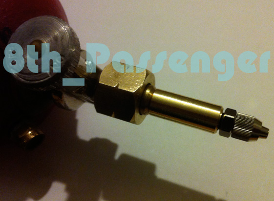

I then turned a brass sleeve (center picture) with a 6mm hole in one end and a tapped M5 hole in the other.
Which fits like this.
Before I solder it in position I think I can shorten the sleeve a bit.

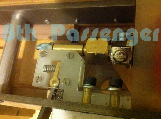

So in position the valve assembly looks like this. Luckily it just fits above the trigger mechanism. But it needs to come forward a little to get the valve knob in the best position.
I need to re design the back of the rear trigger mechanism to sort this problem.
Due to the generous wall thickness of the copper tube I was able to tap an M5 hole in the end to connect the the diamond knurled fitting for the external pilot light gas feed.
I'm concerned the tube I bought may not be flexible enough so I might buy some neoprene tubing to see if that's better. To Disconnect the valve from the bottle I have to be able to remove the propane tank from the rear tube!

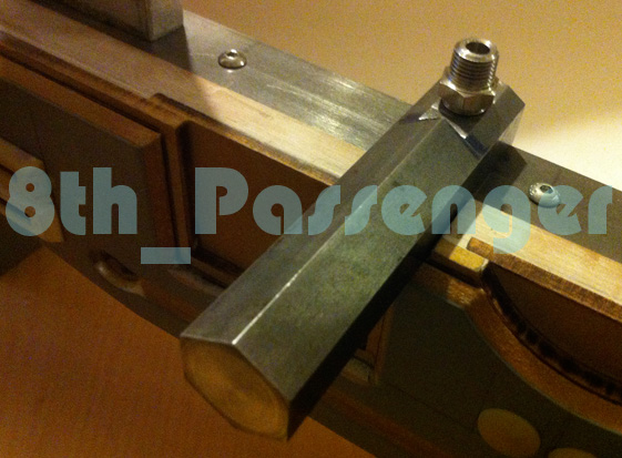

I milled a flat on the underside of the hex bar and drilled and tapped a hole to 1/8 BSP. Then screwed in the fitting.
It needs a bit of tweaking to sink it flush. These fitting have a taper which complicates thing!
In this picture the fitting which will be sunk into the tank is screwed on the hex bar fitting
I feel like I'm moving forward now, resolving some of the more difficult aspects of the build.
More soon.

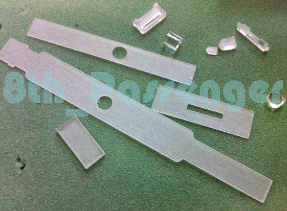

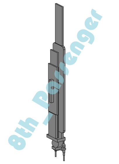

Just a small update. I haven't had much time recently to work on the flamethrower.
With what little time I have had I thought I would have a go at the detail on white tank.
I drew up some shapes in CAD using the reference I had. I came with this.
So I broke it down into parts I could laser cut in 1mm acrylic and slot together.
Assembled here.
A coat of primer on here.
So I'm getting there I think. A bit more shaping and some finer detailing at the base and several coats of thick paint and I should have it!!
More soon.
Colin _________________ Ripley: What's it key on?
Ash: Micro changes in air density. |

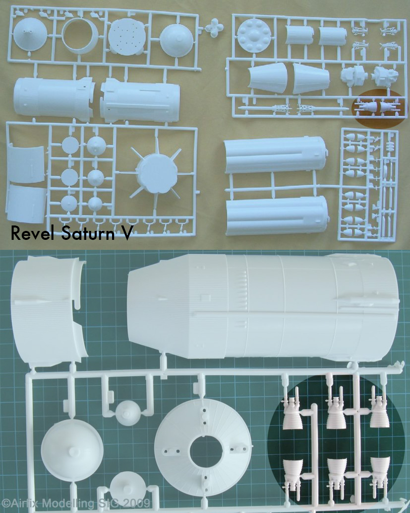

You're welcome Colin...btw, looking at that "greeblie" at the bottom reminds me of the part of an Revel Saturn nozzle  |
ukwookie Community Member
Joined: 30 Jul 2009 Posts: 23 Location: Northern England
Posted: Tue Dec 23, 2014 7:38 am Post subject: |
It's more likely to be from the Airfix kit- specifically the second stage engine  |
Joined: 28 Nov 2009 Posts: 443 Location: Hertfordshire, UK
Posted: Wed Dec 24, 2014 4:58 am Post subject: |
Joberg, ukwookie are we talking Saturn V here?
Both Revel and Airfix have done one at the same scale, 1.144
Here are the parts circled I think you are talking about.
If anybody has these and know's what size they are it would be of great help.
The kit seems to be available for £25-£30.
Posted: Wed Dec 24, 2014 4:30 pm Post subject: |
Yes it's the Airfix Saturn V, the Revell version is the same scale but the Stage 2 engines are quite different in shape (btw the top pic is actually the Airfix Saturn 1B kit which has completely different engines!). I should be able to measure an engine for you once Christmas is out of the way if no-one else gets there first...
Tony |
