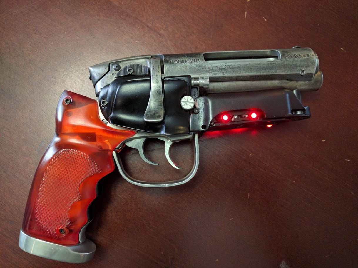

Kokanee
Joined: 14 Jul 2016
Posts: 32
PostPosted: Fri Aug 12, 2016 8:03 pm    Post subject: Reply with quote
Yeah baby!
(Still WIP)
PostPosted: Mon Aug 15, 2016 7:44 pm    Post subject: Reply with quote
Well, there you go It's looking good. Any plan for the final colour of the Steyr?
Kokanee
Joined: 14 Jul 2016
Posts: 32
PostPosted: Mon Aug 15, 2016 10:40 pm    Post subject: Reply with quote
Trying to find something to darken it up some to match the original prop
QuartZ
Joined: 21 May 2007
Posts: 25
PostPosted: Tue Aug 16, 2016 12:13 am    Post subject: Reply with quote
Are you looking to try chemicals next? I think that's where you'll end up. Depending on the metal composition of the casting, dilution, how you apply the chemicals, and how many "passes/coats" you apply, you'll get different results.
Here's some options:
1. Jax: Pewter Black
2. Birchwood Casey: Aluminum Black
3. Birchwood Casey: Perma Blue
Also, your surface prep, polish, and cleaning prior to using chemicals matters! It's a bit of a game and experimentation/practice is the key.
