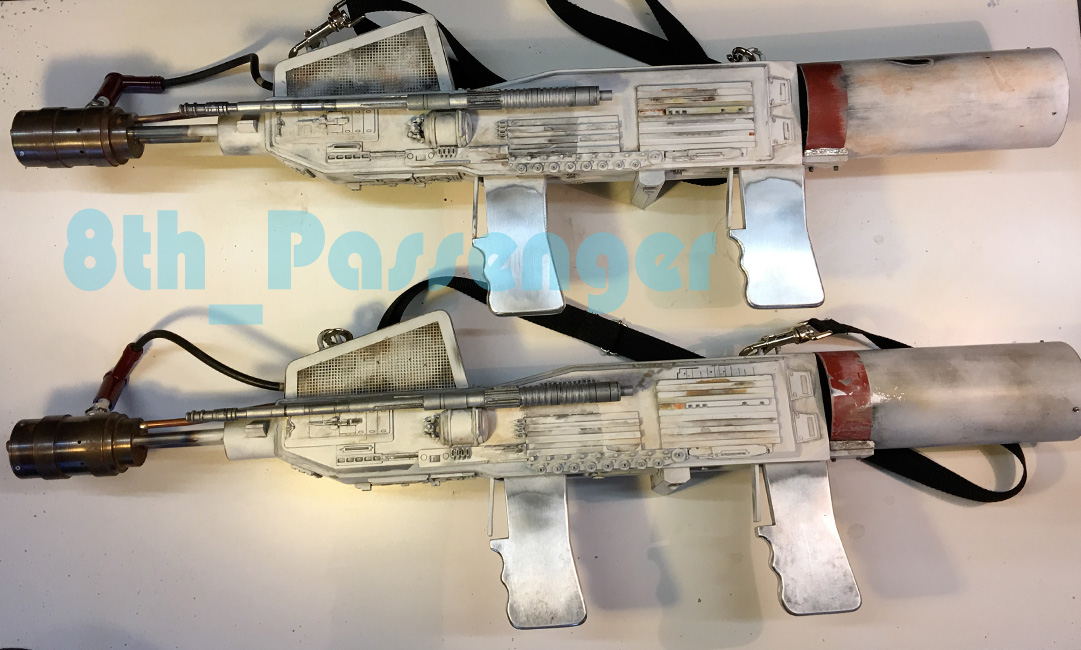

I have actually been making three units since early on in the build.
This is one of the main reasons it took me so long to finish the first one.
They have pretty much taken up all my free time over the last three years. There were long periods where I lost all motivation.
Two are now finished and the third I have put on hold. I need to make something else before I can return to it.
Just a note here about the red stripe on the rear tube. Why is there a red stripe? I put the red stripe on because back in 1987, that's what I saw. It just carried over to 2016. But now I think it's just a dirty mark left by the gaffer tape holding the rear propane canister in place. I have since reworked the paint job on one of the units to be more in keeping with that look.

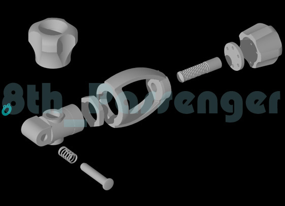

I was having problems finding another Scuba bottle and yoke for the second unit. So I decided to have a go at making one.
I started off by building a 3D model.
The main criteria of replicating this was that it be robust.

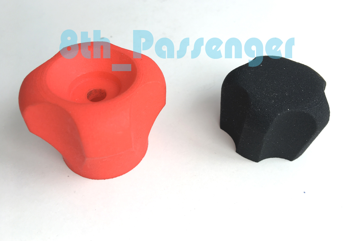

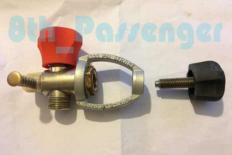

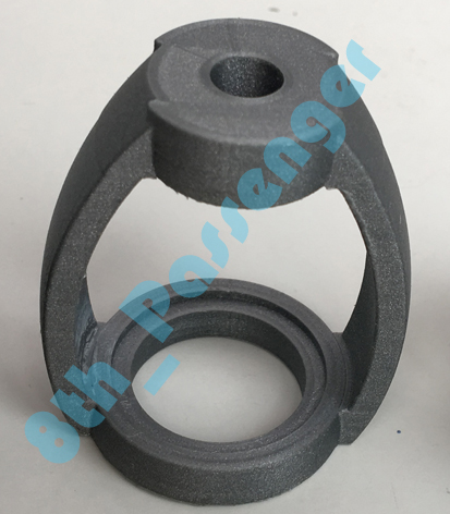

I uploaded the files I had created for the two knobs and had them printed at shapeways.

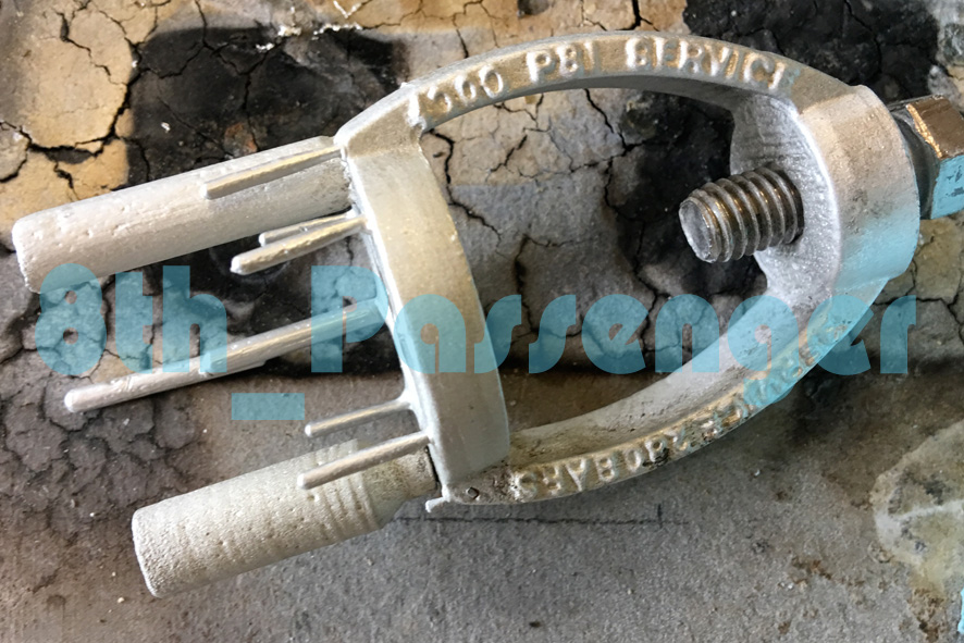

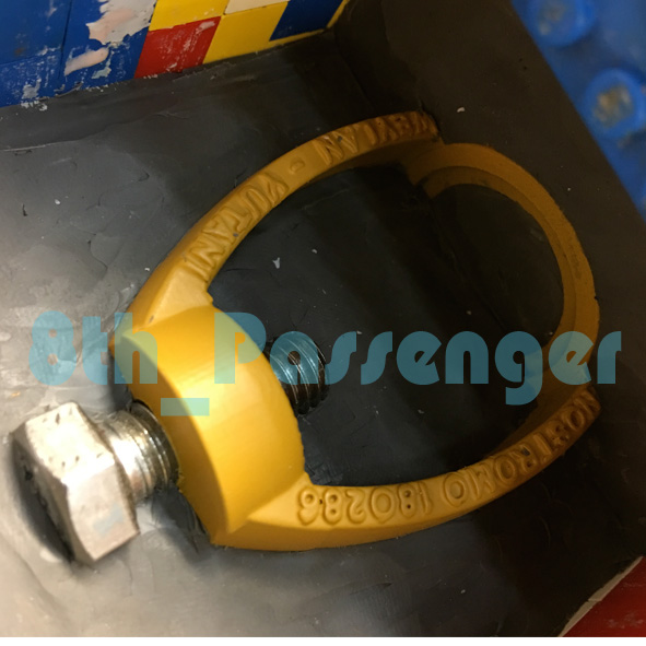

A friend printed me the clamp.

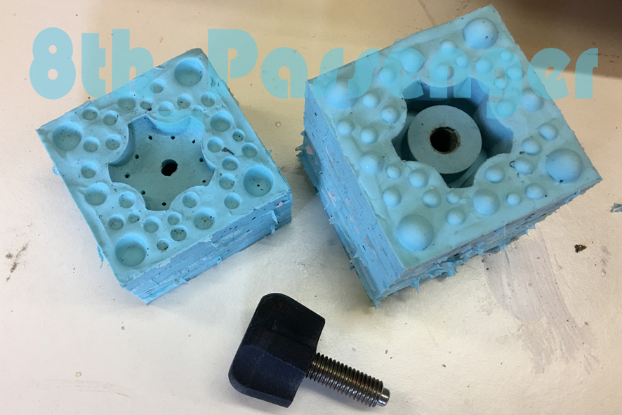

I then did a three part mould of the clamp.
And cast it in white metal.
I cast the black knob with some studding in.

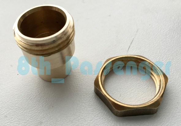

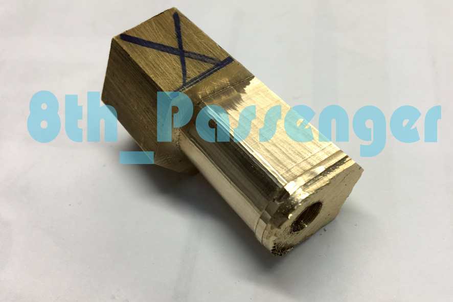

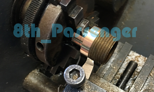

The main body of the valve I wanted to make in brass. I needed it to have threaded fittings, like the real item. To do this I found some plumbing fittings.
I turned these down to fit into the turned brass body pieces.

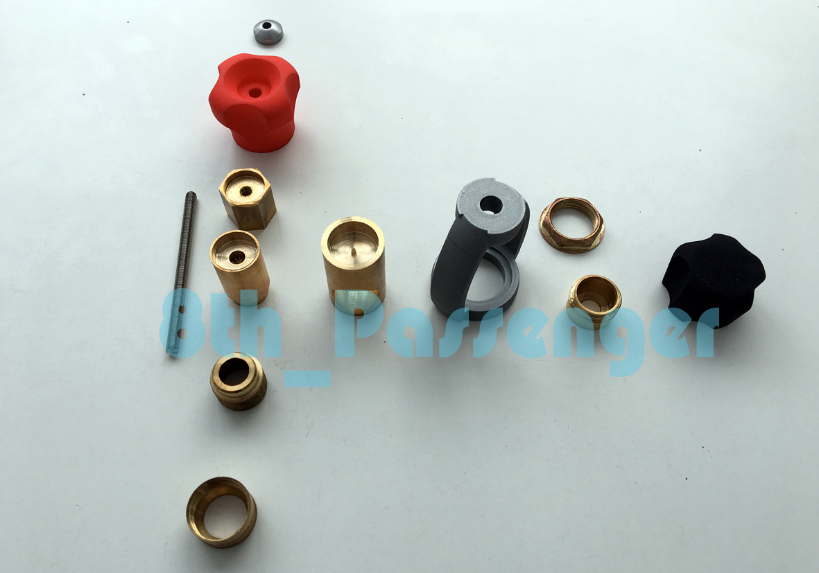

Here's and overview of the parts created.

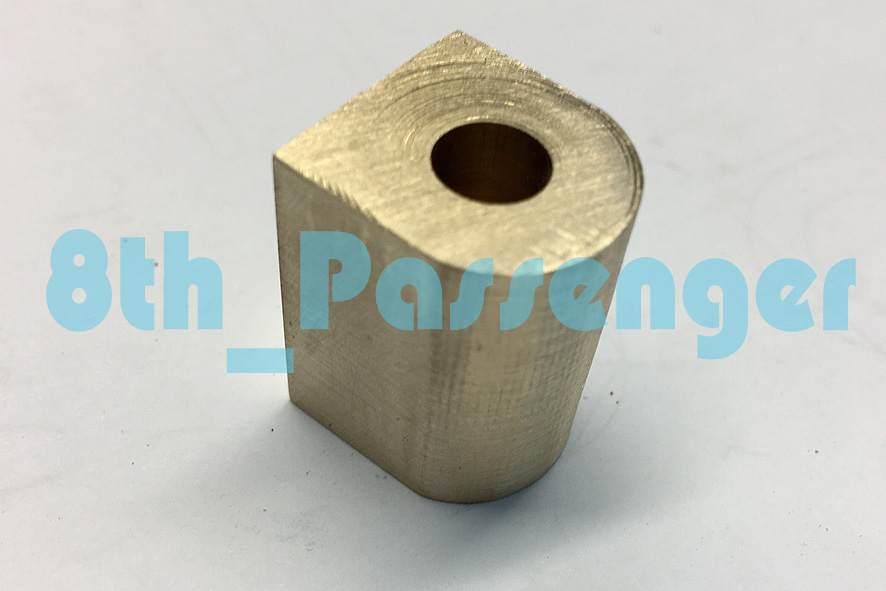

The rear release valve I had to mill.
And then part off on the lathe.

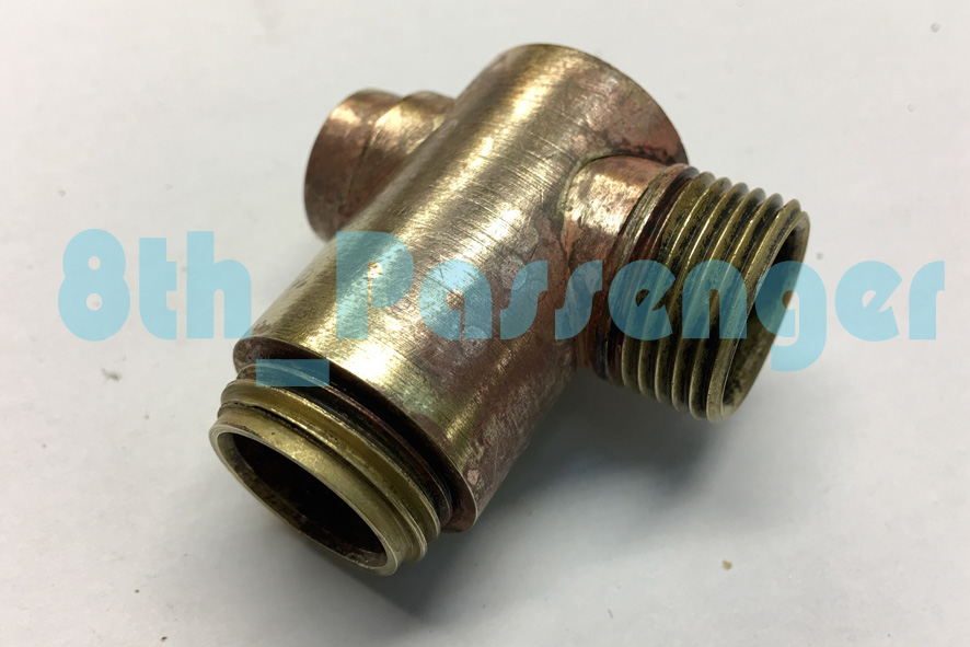

The main parts were solderd togehter.
Ending up with this.

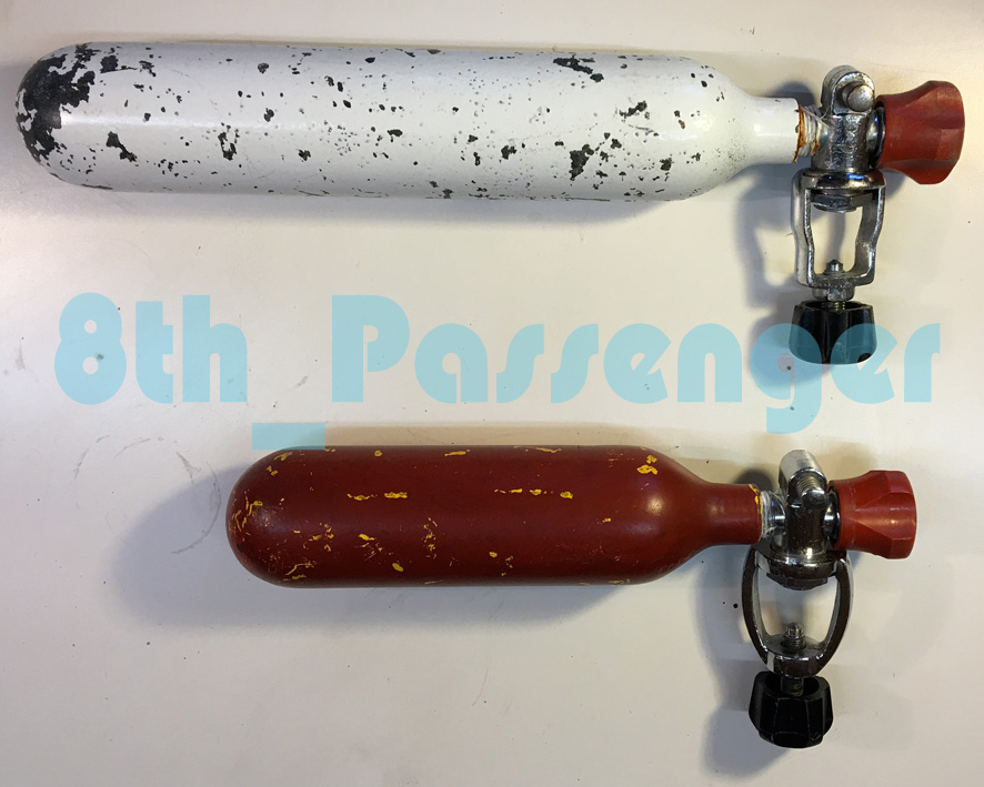

This is as far as I got as finally some real ones turned up on ebay and nothing is better than the real thing.
Interestingly I bought a larger capacity bottle as well. It's nicely aged.

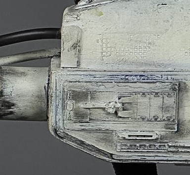

On a recent trip to see the Star Wars identities exhibition in London I was looking at the ILM Slave One model and noticed this part.
which on the flamethrower is here.
On a Slave One thread on the RPF I found out it was a part from this kit.
