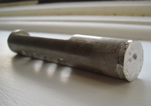

had a go with this just now. works a treat! Smile there are a few gaps that will need filling with the soldering iron but it's pretty much solid.
The diameter of the barrel is the same as a one penny, so I used that to flatten out the end.

That looks so much better than mine did pre-grind. the penny was a great idea!
its crazy how the exterior of the barrel changes color/finish from the heat right?!? You can clearly see how far you filled the end.
What did you use to melt/pour?

yeah the metal goes all white and powdery. it was also still super hot for a while after pouring, so had to let it cool a bit. I used a mini ladle to pour, heated on an electric hob.
here it is after the grind
the extra length makes a huge difference to the accuracy. I'm just a bit concerned as to going about the bevel. I was thinking of securing it in a vice to stop it moving up and down and rotate it into the dremel cutter, something like that.

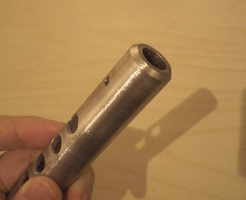

this is pretty much done now. I ended up drilling the hole with a hand drill and filing it out. I tried to dremel the bevel but its really tricky to control, so I filed it by hand.
not as neat as I would have liked it to be, but anything other than that "cap gun" barrel as OB likes to call it Wink

looks great! after seeing yours and feeling I'd ground mine too thin again I re-poured a third time....
what type of drill bit did you you use?

chew: I think the drill bit I used was around 3/8 or 9.5. It was basically smaller than the hole I wanted as the biggest drill I had was too blunt.
so basically used this drill and filed out the hole until it measured around 11mm in diameter.
