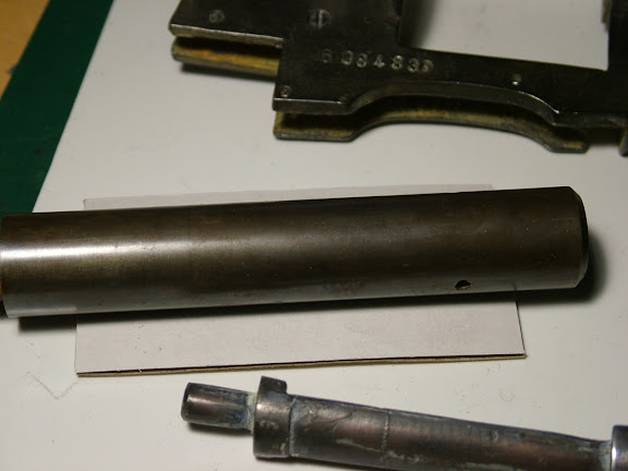

I just noticed the 3 small holes on the top of the real laser sight rod? Wonder what was up with that. _________________ The other Karl! |

| ironfist wrote: | | I just noticed the 3 small holes on the top of the real laser sight rod? Wonder what was up with that. |
Don't know don't even know if they are really there.
Are you going to up load here all the pictures I am doing, it will take a lot of pages...
I though letting them down load things would be better.
racprops Community Member
Posted: Wed Feb 24, 2010 8:38 pm Post subject: |
Just looked at the oringinal picture and they could be light hits, there are light reflections all over this rod in this shot.
Spots all over the rod.
Posted: Wed Feb 24, 2010 10:52 pm Post subject: |
Yep. Those "holes" are spot reflections from the lights. That is also the area where we think we could see the "Made in the USA", that is probably just paint globs.
